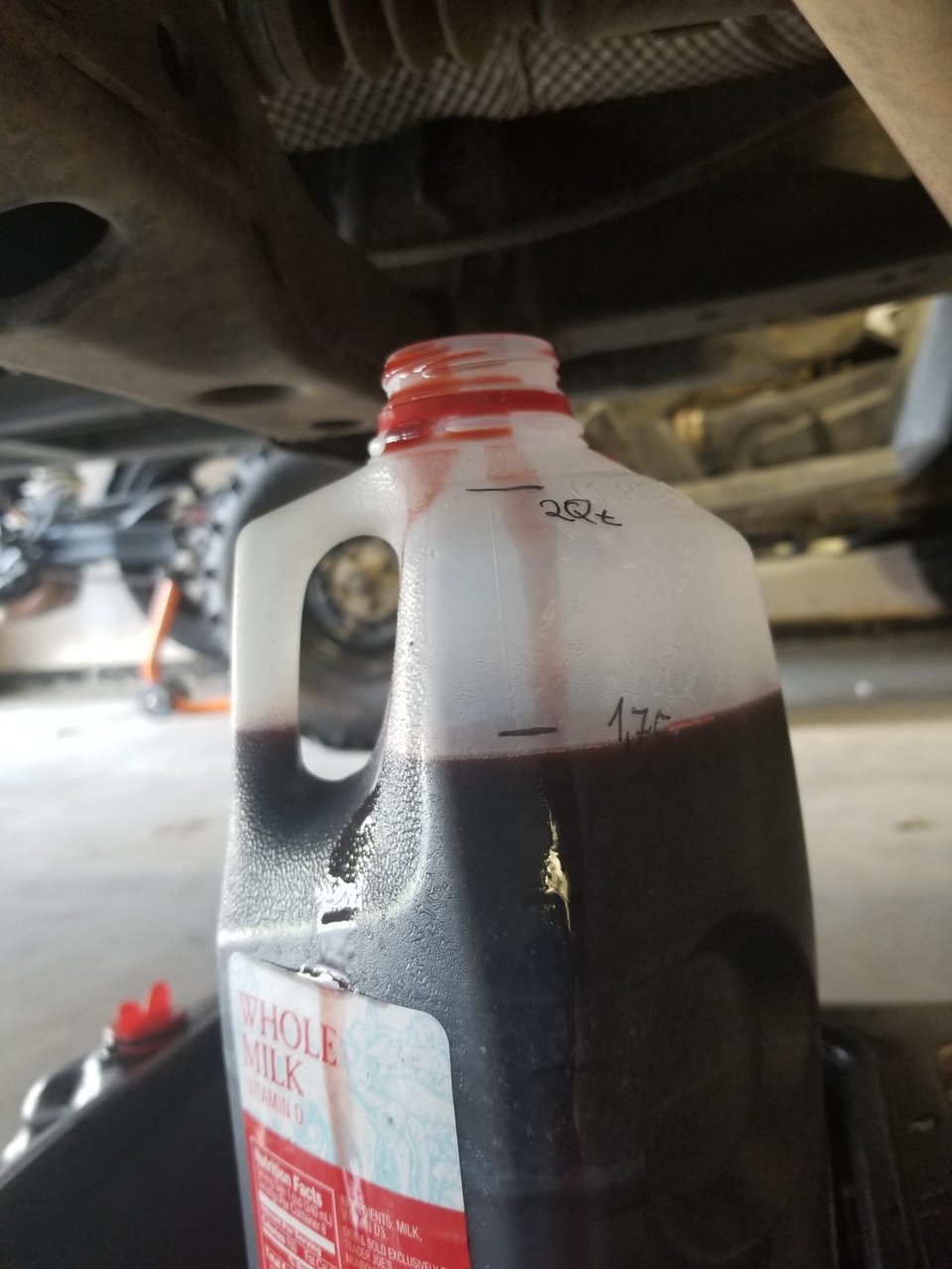

  9. Sep 15, 2019 at 12:55 PM
    #49
    Labbi85
    Labbi85 Well-Known Member
    Feb 25, 2018
    #245606
    217
    Just started the full flush and at initial drain only 1.75quarts came out...I guess that isn't enough right?
  10. Sep 15, 2019 at 1:07 PM
    #50
    cruxofthebisquit
    cruxofthebisquit Well-Known Member
    Jun 26, 2009
    #18936
    5,308
    John
    Orange Texas
    2000 TRD
    OME and worth every penny.
    Change it. Even if for no other reason than dirty fluid clogs up the valve body. Seriously, change it regularly. Should have been all along.
  11. Sep 15, 2019 at 1:07 PM
    #51
    BillsSR5
    BillsSR5 Looking out for #1
    Apr 12, 2017
    #216032
    8,654
    bill
    2014 SR5
    if that's what you drained out of the pan cold, than I would replace with the same amount, when you do the pin jump at temp. overflow check you will find out if the trans was under filled to begin with if no ATF comes out the overflow. I think usually at least 3 qts, should come out the pan initially
  12. Sep 15, 2019 at 1:15 PM
    #52
    Labbi85
    Feb 25, 2018
    #245606
    217
    I want to do the flush with removing the cooler hose, can I now just refill 3quarts do the flush and at the end following the fill up procedure?
  13. Sep 15, 2019 at 1:18 PM
    #53
    BillsSR5
    Apr 12, 2017
    #216032
    8,654
    bill
    2014 SR5
    from what I gathered reading that Flush DIY, the OP first drained the pan cold and measured exactly what was removed put new ATF back in same amount, then started the flush procedure, I would do that not to deviate from that procedure, if you were low at the get go it will show at the end when you temp check pin jump, there may be no overflow dribble then add 1 quart and retry till you get that dribble IMO
  14. Sep 15, 2019 at 1:23 PM
    #54
    BillsSR5
    Apr 12, 2017
    #216032
    8,654
    bill
    2014 SR5
  15. Sep 15, 2019 at 1:27 PM
    #55
    Labbi85
    Feb 25, 2018
    #245606
    217
    But do I not run into the issue that the pump might run dry when I refill 1.75q but remove 2q from the cooler?
    Yeah I printed the diy out and have it next to me
  16. Sep 15, 2019 at 1:29 PM
    #56
    BillsSR5
    Apr 12, 2017
    #216032
    8,654
    bill
    2014 SR5
    no way the whole transmission has at least 10-11 quarts in the torque convertor, so by taking 2-3 quarts in your jug wont empty it not even close, just put back in the same amount you took out, your doing great
