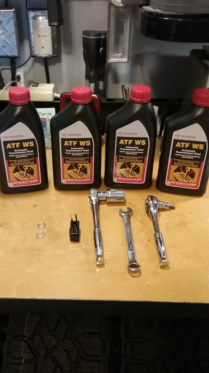

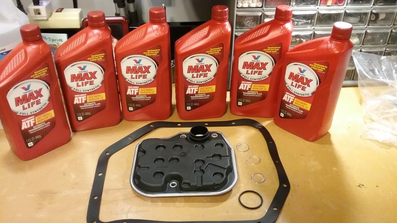

    I did 4 DAFs within a 2 week period at 55k (10k miles ago) to freshen up the fluid. From this point forward I plan to do a DAF every 15k to maintain things.
    I'm under warranty until 125k. So to play it safe I stuck with WS. When I do my pan drop/filter change at 100k I may use Maxlife. I run it in 4 other older high mileage Toyotas with great results.

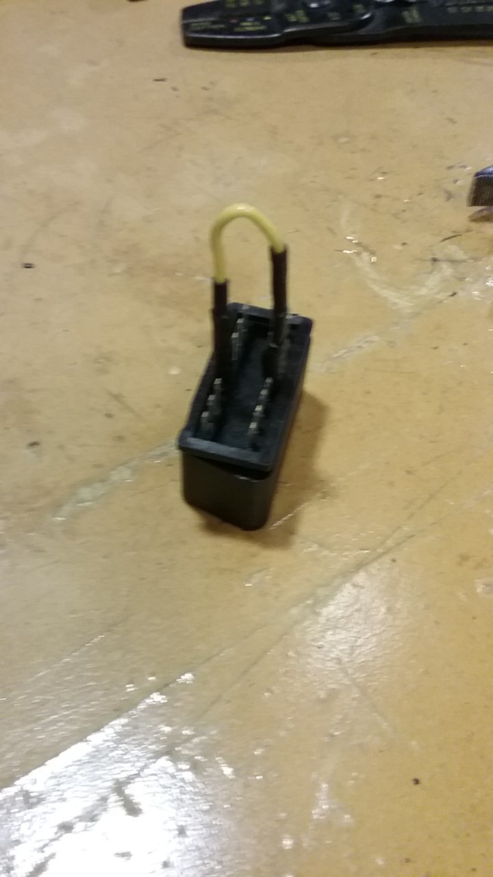

    For an easier time getting into temp check mode...forget trying to shove a wire in there.
    Buy a OBDII plug for $6 off of Amazon and permanently jump pins #4 and #13. Now it's a plug-and-play operation.
