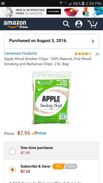

    I found a way to work it. The pellets just don't work no matter what I did.
    I bought some smoker saw dust on Amazon that works well. I leave there chip loader tray half way out and the top vent half open. This provides good air flow and the perfect amount of smoke.
