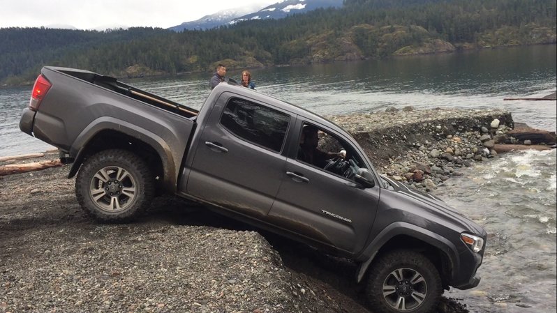

  9. Mar 31, 2017 at 8:03 PM
    CZ5ANM Taco
    CZ5ANM Taco Well-Known Member
    Apr 1, 2016
    #183036
    539
    BC, Canada
    2016 DCSB Manual 35x11.5s
    Front Suspension King Ext Fronts 700# Icon UCA delta joints JD fab spindle gussets All Pro cam tabs DuroBumps Warfab steering sleeves Rear Suspension Old Man Emu leafs -Radflo Ext travel rears Timbrens ubolt flip kit SCS stealth 6 Wheels 35x11.5 Maxxis Razr [ 34.5 x 9.75 on 8.5 rim not on truck] Heavy Stuff Relentless front bumper Smitty 3rd Gen winch Big County Customs skid plates Arc One industries rear HC bumper RCI sliders Misc Arb dual compressor Arb rear locker Pelfreybilt fuse panel tray Cali raised ditch light mounts Cali raised bed stiffeners 5th Gen 4runner LED fog lights Racks Retraxone XR tonneau Yakima load bars Sherpa Roof Rack Camping Smittybilt Tent Dometic CFX50 fridge
    No issues with the same set up you're looking to do.
    It's your truck it's your money.
    Lots of guys running 5100's on here.
    Higher up you go the more likely issues with driveline. ECGS bushing worst case senario. Also you might need to do old man emu carrier drop.
    Enjoy.
    Btw I've seen complaints on icon add a leaf without overload left in. Sags with a tissue box in the back. Are the words I read. Then also saw those same icons for sale later on Craigslist.
