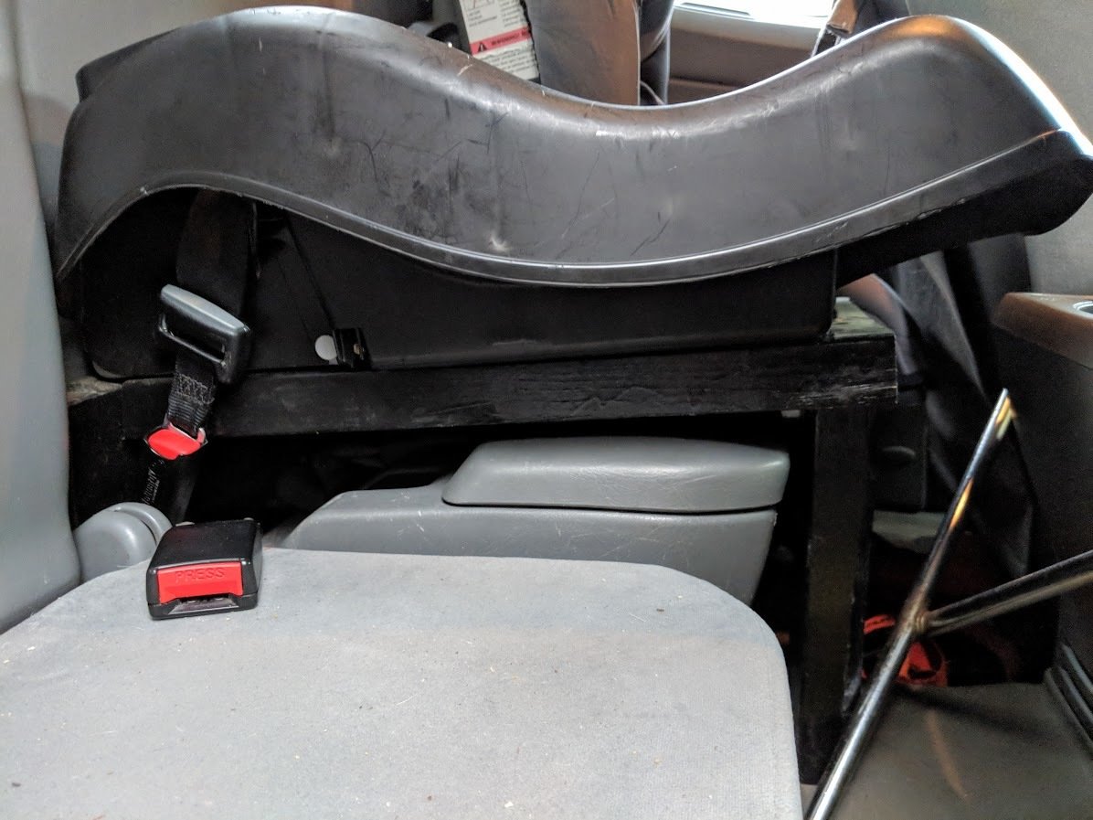

    - A piece of 1.5 inch angle iron about 14 inches long. Drill 2 holes in it aligned with the "inside" seatbelt bolts, weld 2 chain links to either end of it, bolt it in.
    - A piece of 2x10 lumber about 2 feet long
    - A piece of 2x4 lumber, mitered lengthwise and screwed to one end of the 2x10 such that the long side of the 2x4 hooks BEHIND the angle iron you previously bolted into the seatbelt mounts, and where the angle that you mitered the 2x4 at holds the 2x10 at the correct angle for the rear-facing child seat.
    - A piece of 2x6 lumber about 2 feet long, cut square, from the "floating" end of the 2x10 down to the floor. Screw the 2x6 to the 2x10.
    - Paint it all black so it doesn't draw funny looks.
    Optional:
    - A couple of strips of stick on velcro on both the 2x10 and the bottom of the baby seat base to hold it from sliding. Remember that normally, baby seats sit on a fabric seat, which isn't slippery like the painted surface of a 2x10.
    or
    - Carpeting. Preferably GREY to match the truck's fabric.
    You hook the LATCH clips onto the chain links you welded to the angle.

    Mine's '11.
    First, the overall side shot. Obviously, the actual carrier isn't there, since I don't take the baby to work with me.
    Then, best shot I could get of the mount. Note that mine's with a 2x6 across the back, and the 2x10 butted up against it from the side. For structures similar to this, I'd normally have put a 2x4 under it to sit the 2x10 on, but I didn't have a 2x4 at the time.
    For my next trick, I'm going to have to rip out the compartment and build an actual seat in that spot. That happens when the smallest one switches direction.

    Looks Great! I get the idea. What did your S.O. say about it?
  16. Nov 1, 2018 at 12:56 PM
    #36
    96carboard
    96carboard Well-Known Member
    Sep 14, 2018
    #266237
    1,593
    I explained the physics of it to her and she understands that it can be no less safe than factory installed.
    In fact, this is actually *stronger* than the factory mounts.
