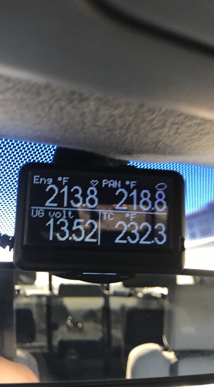

    I copied this from another post but
    With the truck at 200 degrees I shut off the motor and the fan nearly immediately stops once the motor is off. Also my truck CAN idle for 20 mins straight with the ac on and not get over 200.
    -it has the same amount of friction cold/warm/hot which is not much. The fan is noticeable loud on a cold start but never after that.
    My issue was when off-roading in 4lo it gets super hot like 210-220 and once to over 230. It also gets hot over 210 going up inclines or with a load on the motor.
    I got into contact with the previous owner and he said it went to the delearship 3 times for a similar issue. His problem was it would get too hot when driving slow or in stop and go traffic. He said it would go down if he revved the motor in nuetral. The dealership replaced the thermostat (100k miles) but he said it still happened after that. I can sit and idleall day long without breaking 200....BUT this really makes me think it’s the fan??

    It never overheats while idling only if off-roading. It doesn’t really overheat but runs too hot.

    But overheating on the trail when I was with multiple other tacomas and they weren’t even over 200 yet I’m over 230....that’s why I’m worried mainly.
    It went all the way to the red and I had to shut the truck off....can’t be normal

    It doesn’t spin free. It has the same resistance as cold. I would say if you spin it it goes from the 12 position to the 3/4 position

    Even though it is the same as cold/hot it does not free wheel and does stop spinning as soon as the motor shuts off.
    The fact that the previous owner said the truckcwould start to overheat in stop and go and would rev the motor in nuetral leafs me to believe fan??
    Or is it water pump or radiator?
    I had it idling for 20 mins today while it was 95 out and it was 199 when I got back to the truck.....tranny cooler is on order too
