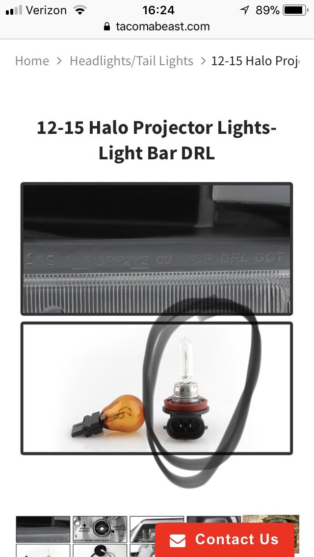

    Yea you can tell, at least on Tacoma beast website, they show you the base of the headlight bulb it takes and it’s an h8, h9 or h11 bulb... I just thought they were all single filament bulbs

    247B45EF-1D0C-4986-B171-21811A33EB68.jpg That’s an h8, h9, or h11 base. They’re interchangeable

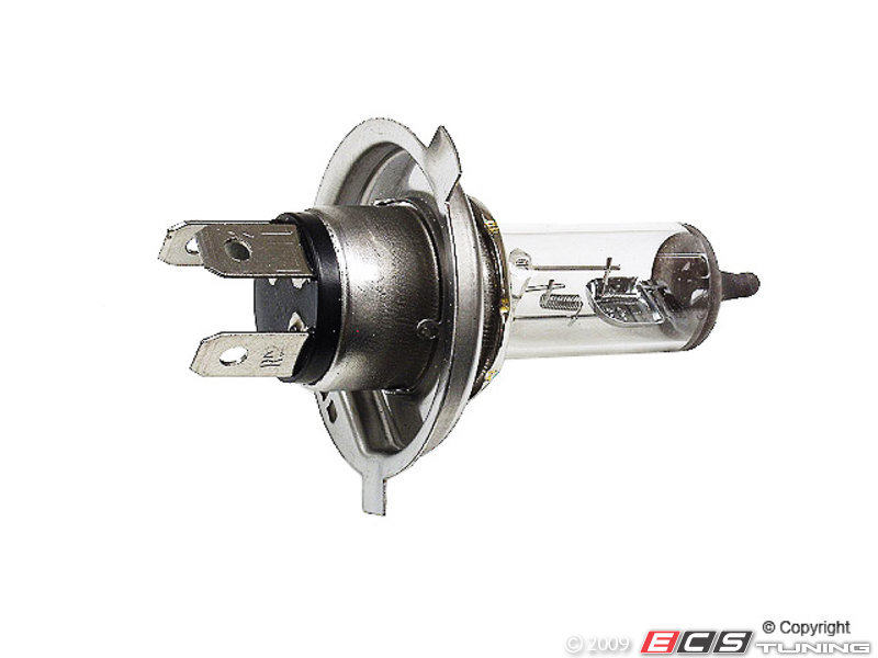

    The difference is the stock bulb is an H4 which is dual filament...so the low is one filament, then when switched to high, the second filament lights up for high beam.
    With the single filament you are basically running the bulb at its full blast, with what I am assuming is a cover plate blocking out a high beam, and when you engage highs it actuates and gives you a high beam pattern. The bulb is just fully on regardless.

    This is the stock bulb for the 12-15 Tacoma D1D0ADDF-2022-41B5-9DDC-4D982084EE26.jpgit has three prongs that connect into our harness where as the h8, h9, and h11 only having two prongs (positive and negative). The third prong on our stock bulbs is to activate the second filament in the bulb when we flip on the high beams. When you go to a h8, h9 or h11 bulb, it’s a single filament bulb so you need to either run two bulbs (one for high and one for low) or there’s something mechanical that happens using only one bulb that I don’t understand.
