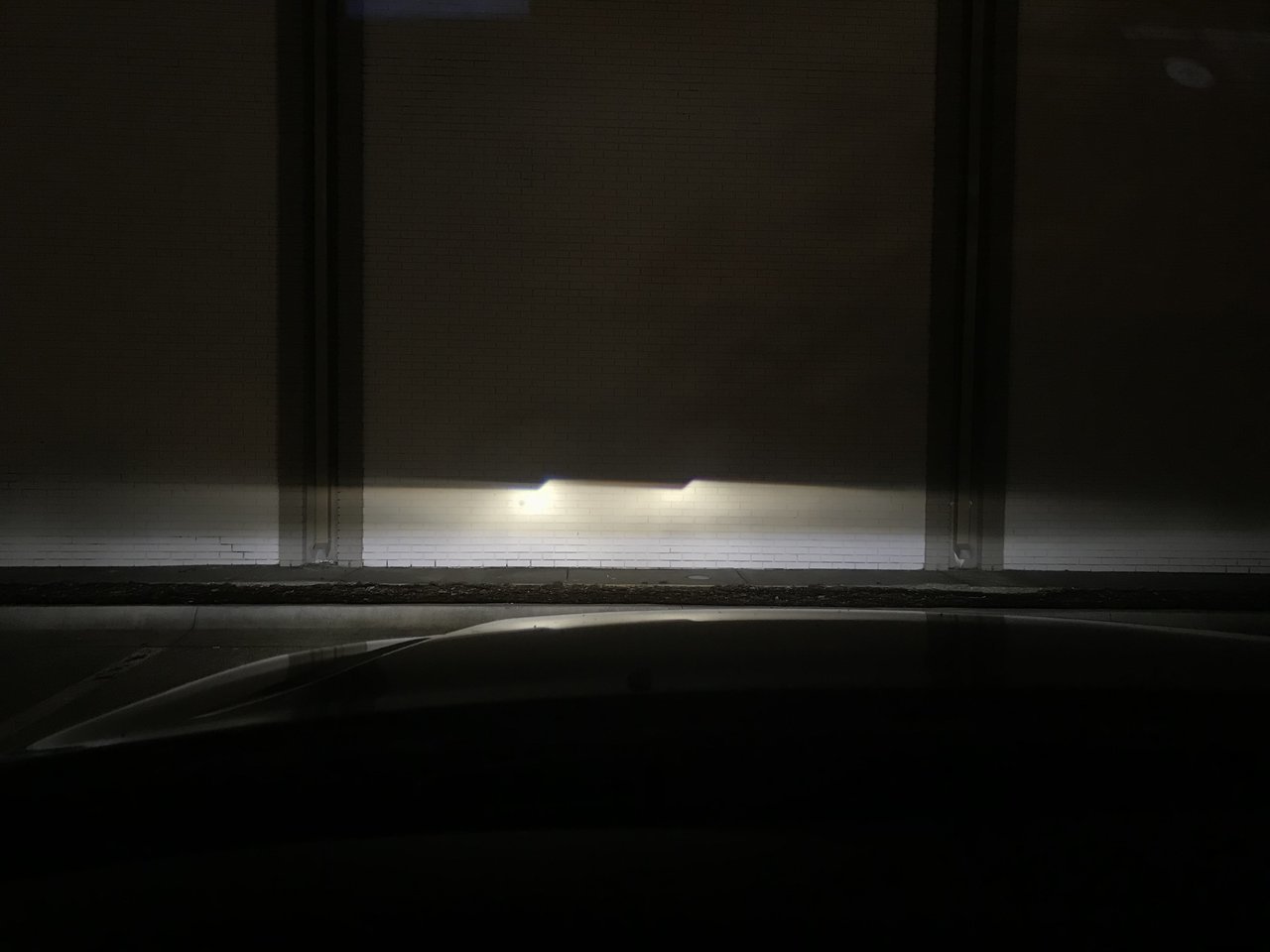

    I probably look like a terrorist by now, I keep measuring that building and parking by it. Oh well.
    I did the low beam cutoff to drop 2”, and the fog light cutoff to drop 4”. The difference between the two at those levels is 16”.
    The fog lights are awesome. They are very wide, lighting up the sides of the road next to you.

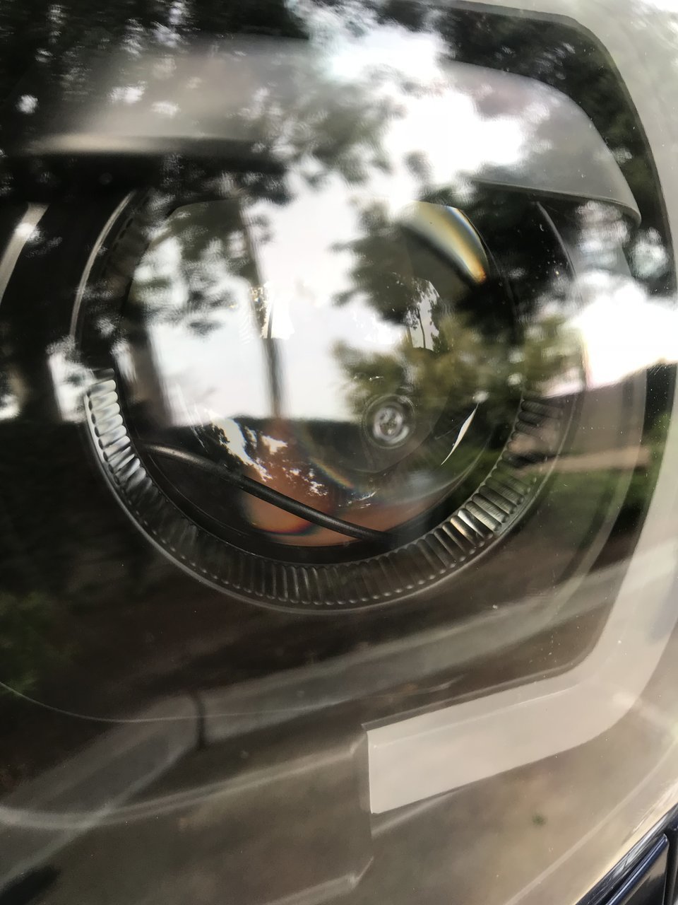

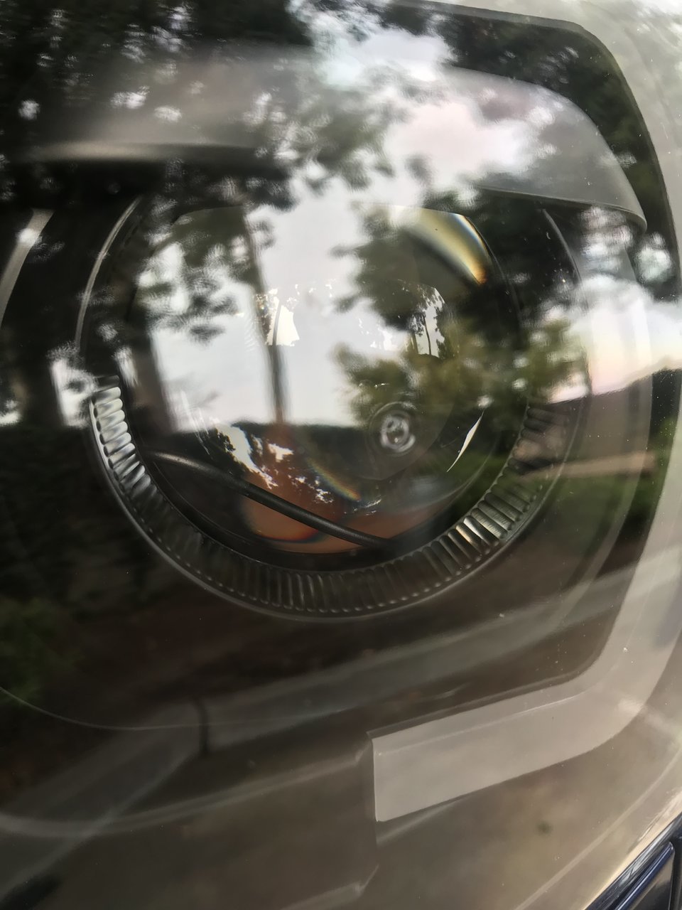

    Working on mine now.. i noticed one of the wires sticking out near the light output

    The joys of aftermarket parts. Try to remove the rear boot and fish the wire down and behind the projector assembly.

    You may want to use the vertical adjuster and move it away from that wire as much as possible before trying to pull that wire tight. Probably by adjusting it down more.
    I read somewhere that the projector actually moves when you make that adjustment.

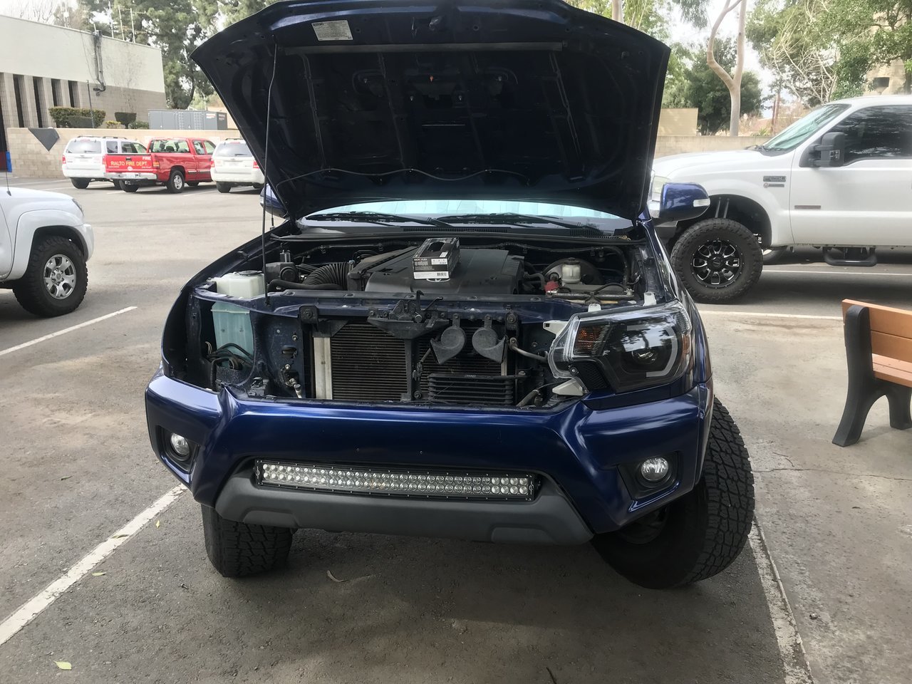

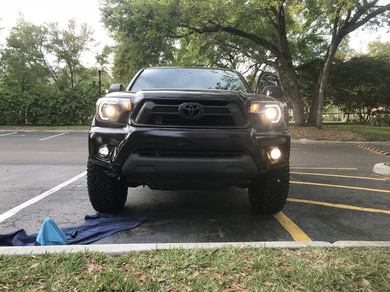

    Thanks for the input guys. I was able to move the wire and place it on the back of the projector with a screwdriver.
    What do y’all think?
    Light output pics to follow once it gets dark...

    Your truck looks amazing.
