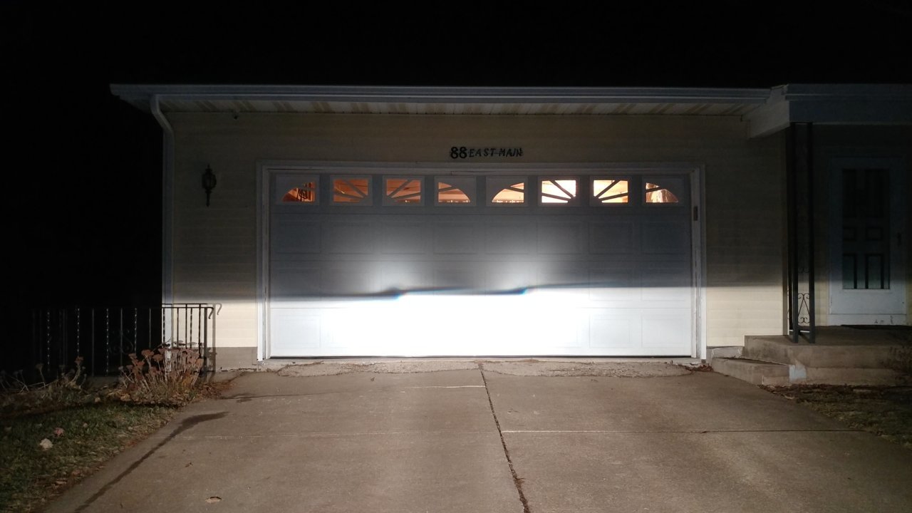

    This is the output on my 08. No aiming yet but they turned out good I think.4E76BB2F-AE68-426A-9824-C542E69E2C2E.jpg 685D4D2A-7B7B-45C2-AD31-5137164D83BF.jpg

    Any shots against a wall 25ft away?

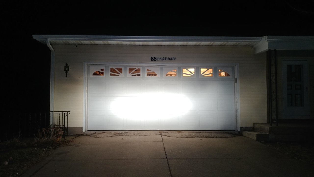

    I’ll try to get some later this evening against my house. I’m assuming that’s the correct distance for aiming? I’ve never actually done it before hence why I haven’t aimed these. Still had some research to do on the process. One thing I have noticed with the way the lights are designed is that you don’t get much light output towards the ditches on bright like you do with factory. It’s all focused ahead of the truck. You can see the led strip light against the trees though.

    Yeah thats the proper distance, 25ft away from a flat wall, the light should be focused 4 ft off the ground. Ive read that the lights are somewhat crosseyed, im sure they require fine tuning. They look like they have descent output.

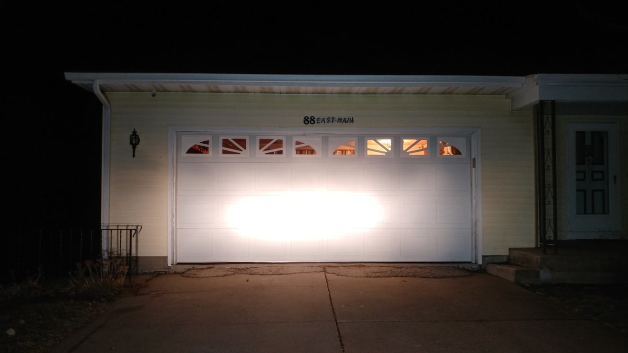

    BA371B7B-B327-4E14-8152-E51E66CB5F35.jpg It’s not quite factory but it’s close. The output I mean.

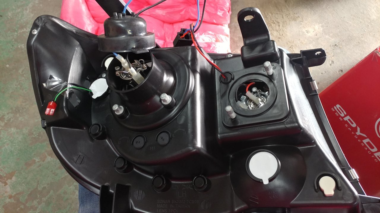

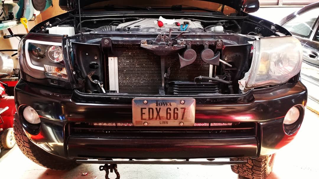

    These got delivered and installed today, have yet to aim them but I think they look 100x's better then my shitty oem ones.IMG_20181208_173154_212.jpg
    A little comparison
    Bulb on left is old PNP LED 6500k in reflector housing. Bulb on right is Osram Night Breaker Unlimited halogen in new housing on high beam reflector
    Left bulb, old LED setup, right bulb new Osram halogen in projector housing on low beam.

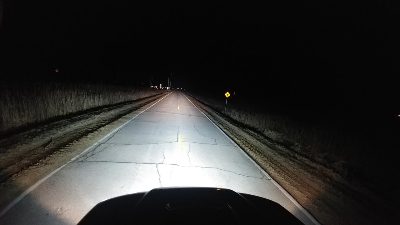

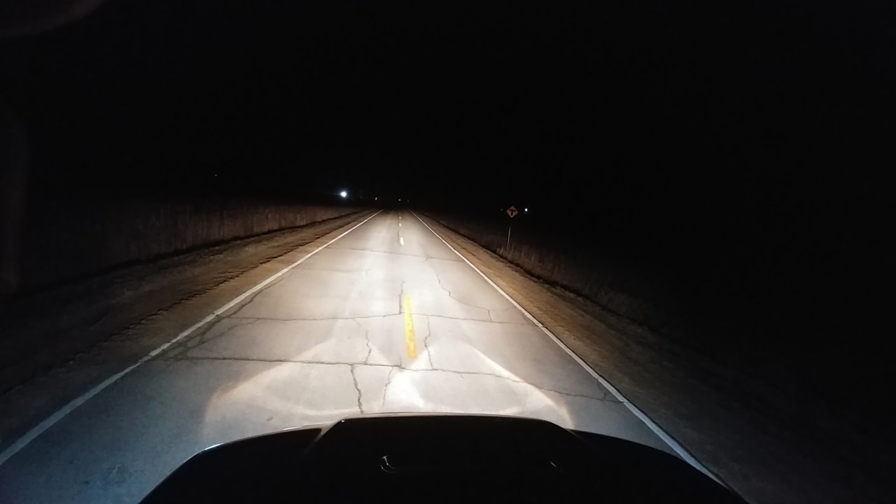

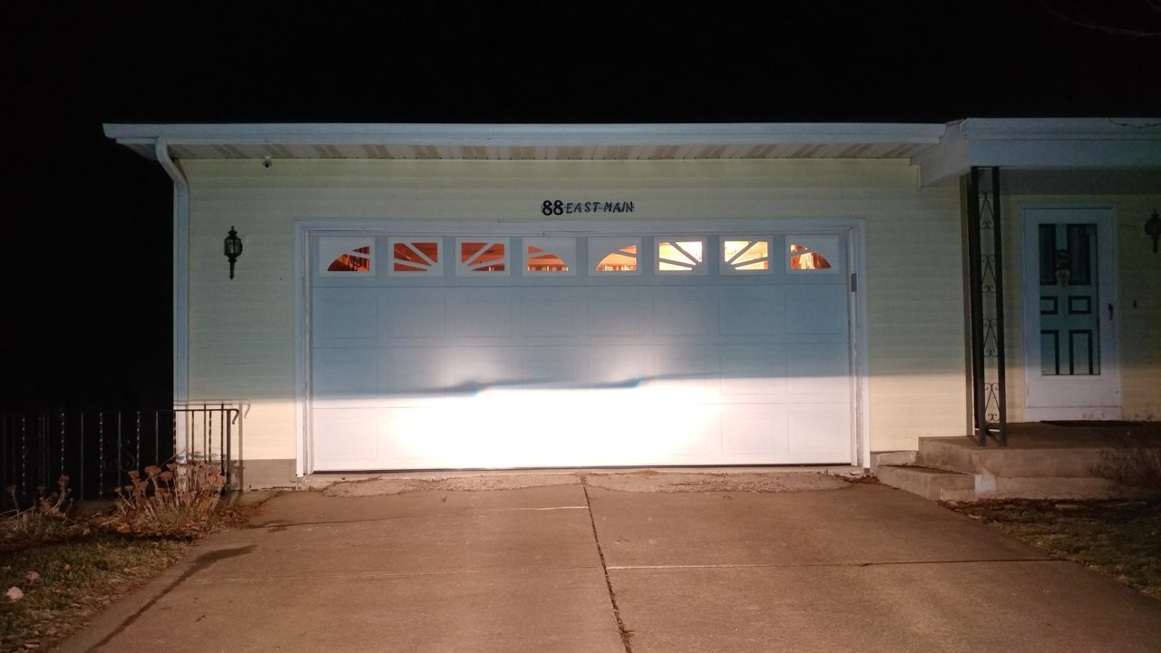

    Went out and got some night shots, only had to do some minor adjustments in aim (as good as it gets).
    My initial thoughts,
    Its nice to have a light cutoff on the low beams. Even tho these are halogen projectors they are still better then my blinding led setup.
    A proper HID projector setup would have much better light output and a cleaner cut off.
    I really like the modern look to these lights, the LED dtrl strip is actually pretty bright at night.
    The high beam reflectors work well directly infront of the vehicle. They leave much to be desired for peripheral lighting, I could see where a pair of ditch lights would help tremendously.
    Final thought, I may eventually do a HID swap on these, but I think I need to do ALOT more research before I dabble into that. I will be upgrading my fog lights next month when Baja Designs releases thier new DOT fog lights. The LED bulbs glare a ton in the factory fog housings.
    Heres some night shots, I have yet to see too many output pictures of these headlights, so Ill try to contribute.
    Bulbs are Osram Night Breaker Unlimited halogens, both High and Low beam.
    Low beams only
    Low beams + LED fogs in factory fog housings
    High beams only
    High beams + LED fogs
    High beams + LED fogs +32" Cali Raised 5D lightbar stealth mount in bumper.

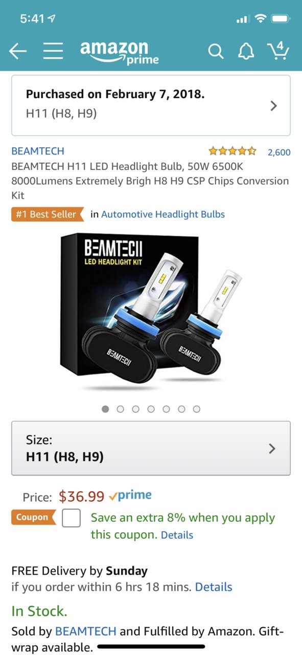

    The beamtech led lights I listed a few pages back are perfect because the seal fits over them. i had a hard time finding ones that would fit due to the fan on the back of the leds but they’ve worked perfectly for me for over a year so far
