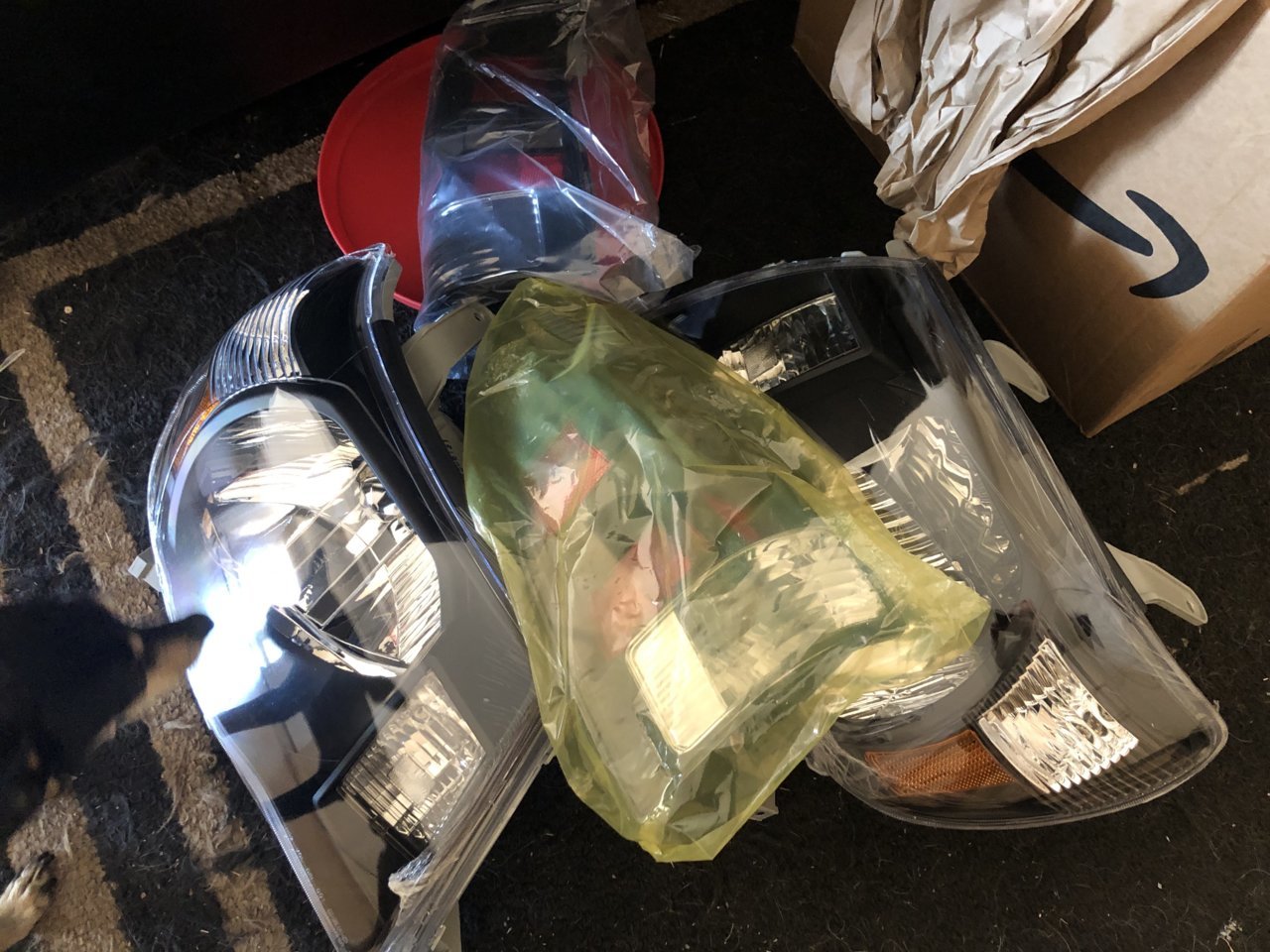

    If you do get water spots you can slosh just a little bit of rubbing alcohol in there and that should remove them. Be careful not to get the alcohol on anything but the plastic though.

    So I got the water spots out. My new bpf grille is coming today so I will reseal them when I do the grille. What kind of sealant do I use? Also I'm running around with a clear trash bag on my headlight because it's raining.

    This stuff is supposed to be great: https://amzn.to/2HbP3Id

    Is there anything I could get at oriellys, AutoZone or a Lowe's or home depo. Wanting to reseal them today

    Dont remember the brand. But it was a white tube with red markings. Got it from advanced auto. Believe it was rtv sealant
