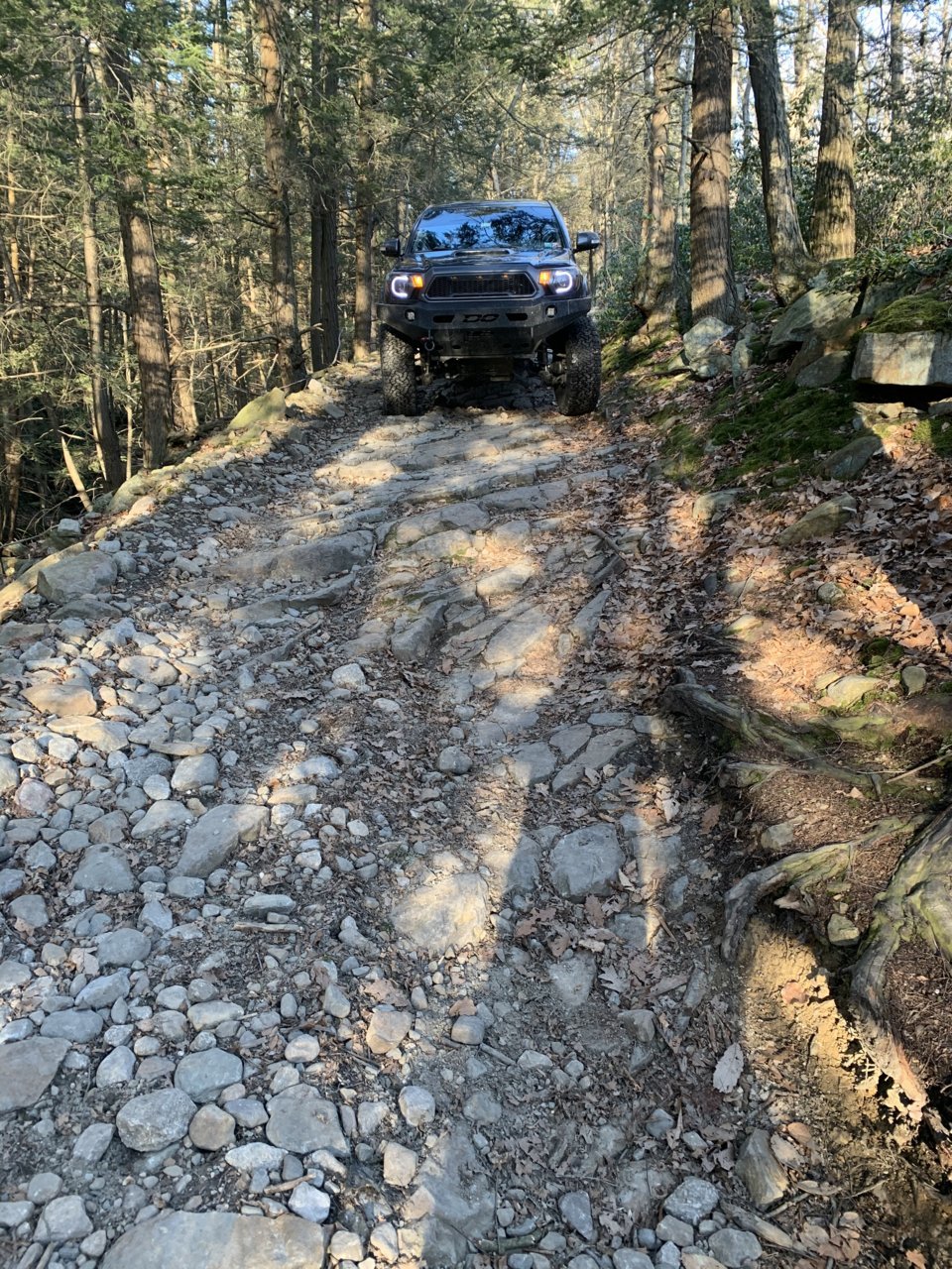

    I've got them on my truck. Visibility sucks, I even upgraded to LED bulbs. Significantly cheaper on Amazon. Looks great but there is a cut off line at night

    Nice looking truck! Your headlight problem is partially due to substandard aftermarket headlight housings and their optics, but it's further exacerbated by the LED bulbs. The sad truth is that they just aren't the "upgrade" that the marketers say they are. If you stick with those housings, you'd actually get marginally better lighting performance by going back to a halogen bulb.
    I would love to say that our resident lighting expert (@crashnburn80) is in the process of doing another one of his unbiased, scientific tests of aftermarket headlight housings, but the truth is that there are just too many of them out there for him to test all of them. What he has proven is that short of a high quality (and fairly costly) projector retrofit, the best performing headlight upgrade for our 2nd generation trucks is his Ultimate Headlight Upgrade. Mic drop.
