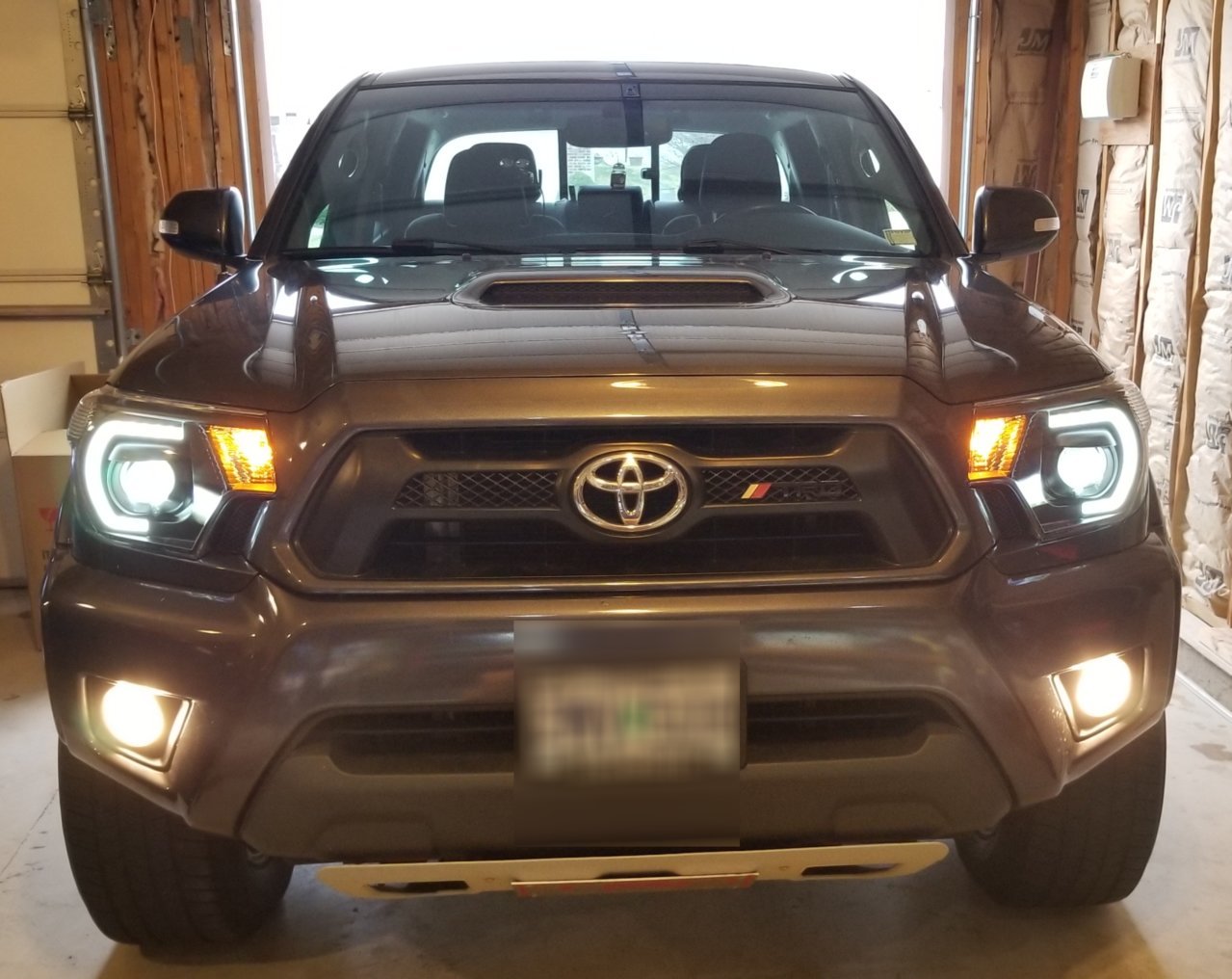

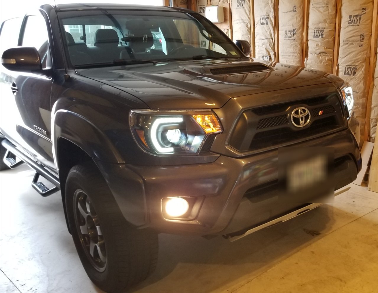

    No condensation in the headlights and nothing is melted. I'd say they're good.

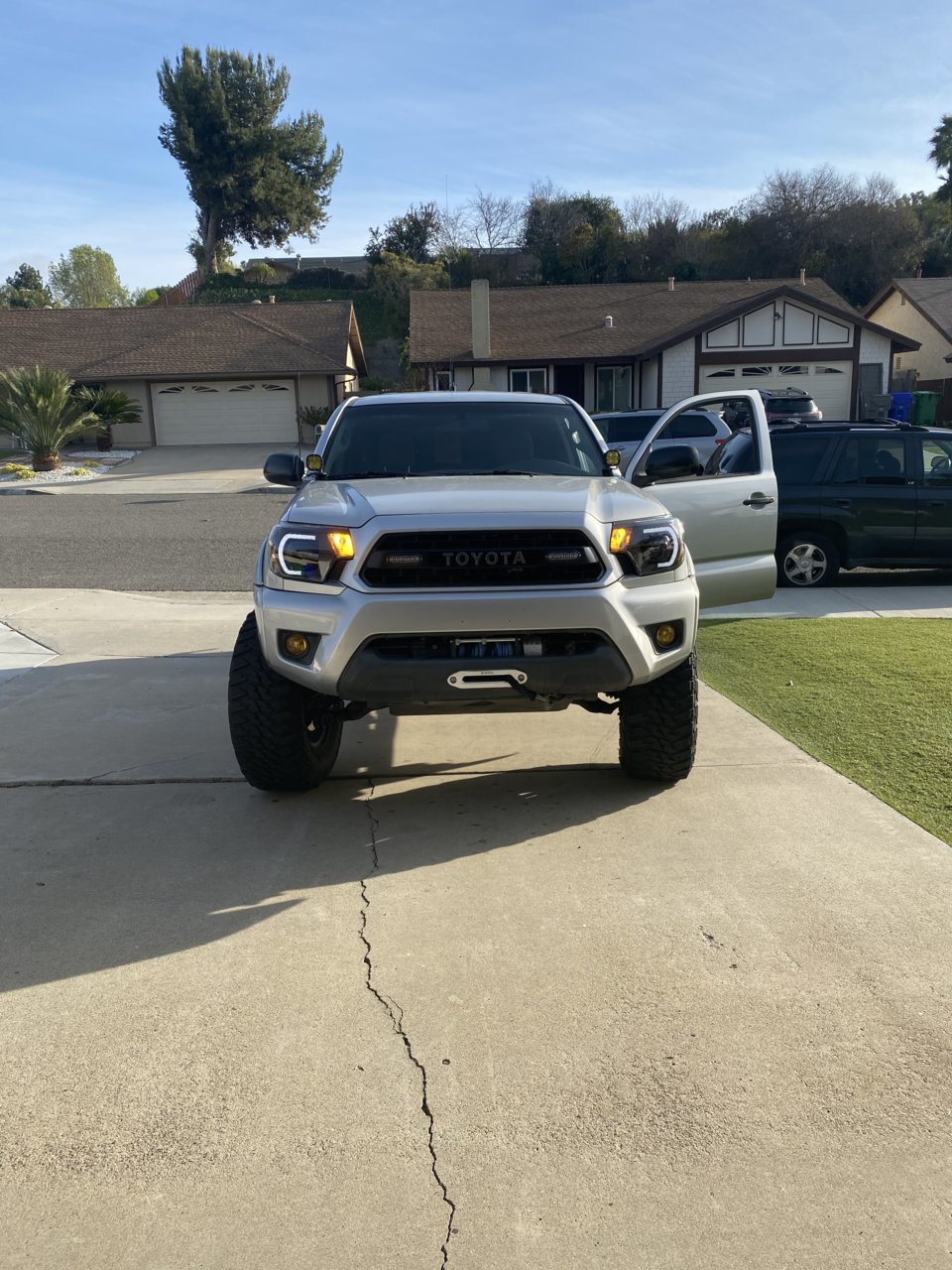

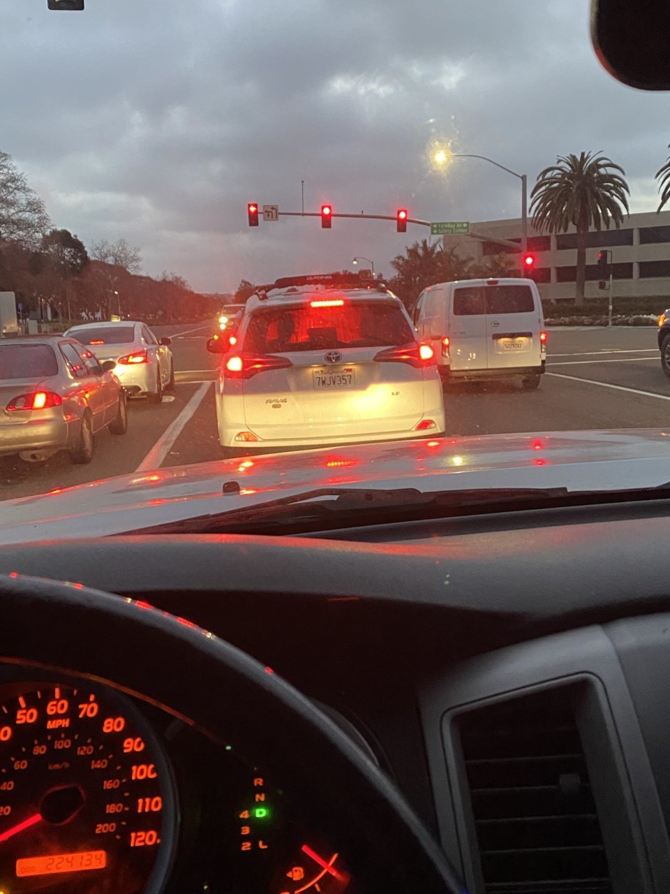

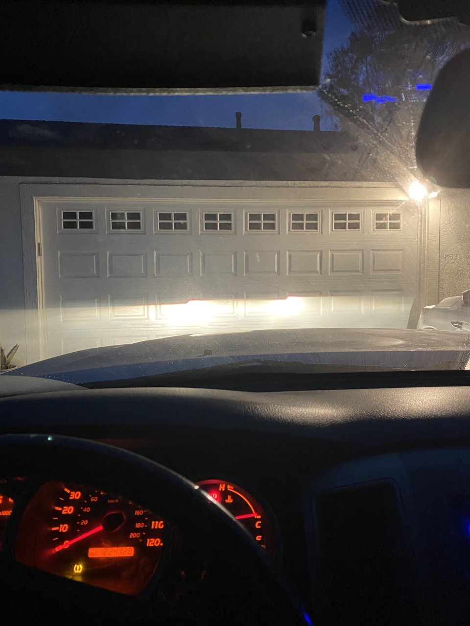

    Not too bad, they don’t seem to adjust though.

    I also able to adjust mine just fine. Have had a few pairs of aftermarket lights and they always have a jagged upper line. When I looked real close inside the projector, I saw thats the shape of the housing. Have also seen it on display pics on here of "high end" retrofits people sell.
    The only gripe I have is the high beams are basically useless. Lows are pretty good though. I don't care about the highs though as I have my lightbar triggered on by the high beam relay.

    I had those lights for a little while, they adjust up/down and left/right. I think it was with a screwdriver.

    The "jagged" cutoff line is so that the left side of the beam is less likely to blind oncoming traffic. That's why the left side of the beam is slightly lower than the right.

    Does it look like I need to adjust the drivers side up then? Didn’t know it was normal. Was odd with the passenger side lighting further down the road. These are light years brighter than the eBay reflector halogens I had before. Debating a HID kit.
    I tried with the screw driver this morning and nothing moved the beam. Going to try with a ratchet tonight

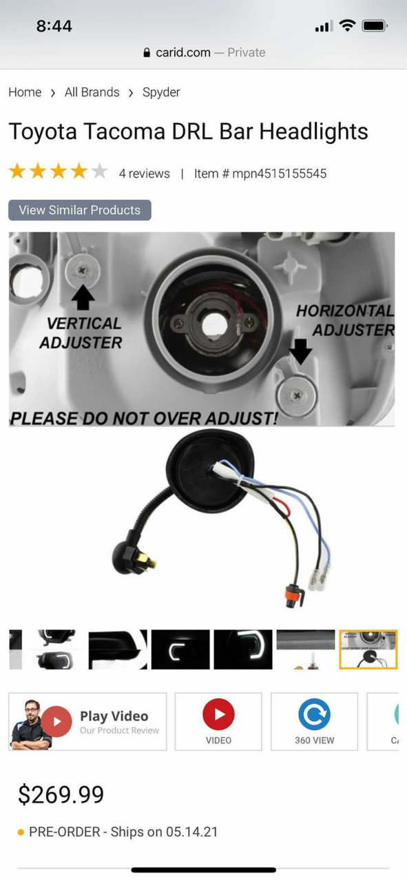

    Does this look right? I think oem the bottom was for vertical adjustment

    Yea, philips screwdriver. Had to buy 1 with about a 12" end though as I was struggling to reach one of the adjusters.

    I don't think so--I think you're good as-is. You want the light cutoff to be a bit lower on the left as a result of the notch. The passenger light will be less impacted by this (if at all) because the beam from the driver side will fill the gap. It takes some getting used to.. I used to have a D2S retrofit on my last car, and it was the same cutoff pattern.
