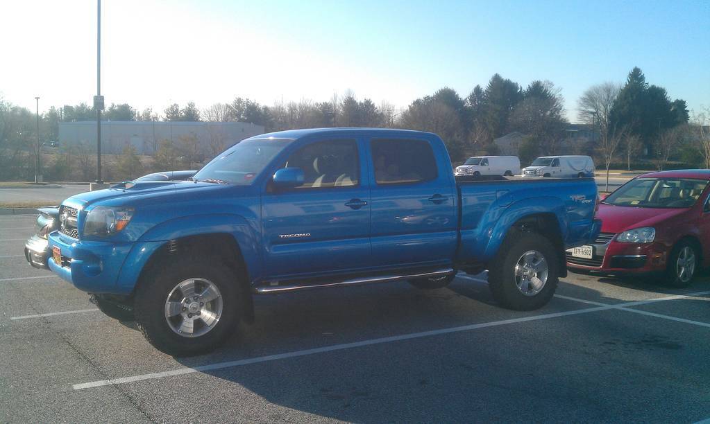

    I was looking at getting the same lift but decided to get this one. It has the axel shims and diff. drop which are needed IMO. The only thing that I need to get is new UCAs because of my 285 BFGs (Rubbing when making tight turns). As for the install the front coils are easy. The rear took a little time with the Add a leaf. In all it took me about 7 hours to do the install this weekend with help from two other people which have never done this.
    Here is the end result.
