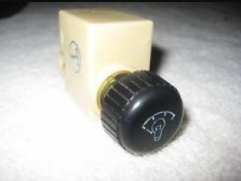

    Does anyone have or know what this switch is?

    That, (now that you've uncloaked the photo :D) looks like an old fashioned dash light rheostat (dimmer switch).
    Feed it 12v and measure outputs with a DVM
    Or use an old bulb/socket, feed it 12v, temp connect to the terminals and see if it works.

    looks like the stock dimmer in my 99

    The pic in the post now is a rheostat. It dims or brightens the dash display lights.

    Yup dash light dimmer.
