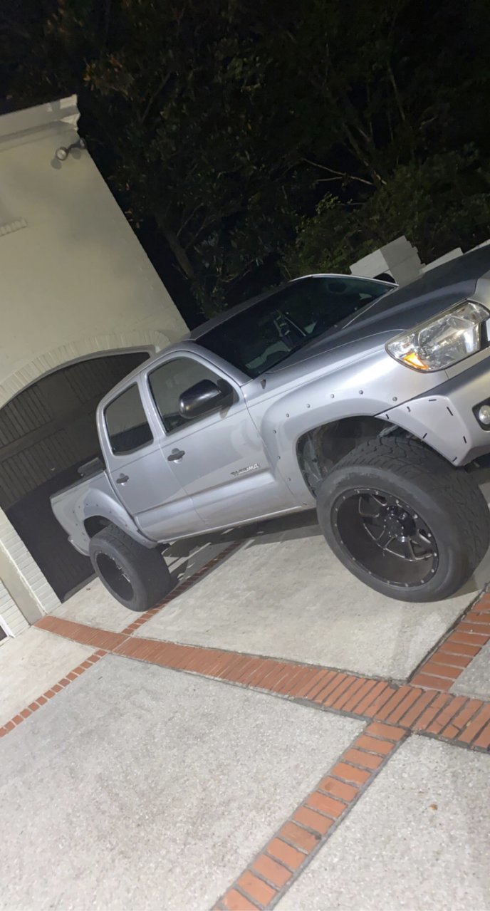

Does anyone know if it’s possible to fit 35s with a 3inch suspension lift?

    2014 trd tacoma
    A lot
    Trying to switch up from my 20x12.5s

    Not impossible but takes some modifications. I have a 6" lift on 35's and I rub a little. First thing to do is get an alignment adjustment, caster out to 3 degrees
