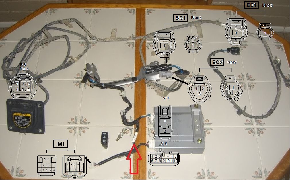

    You can, it be either expensive new OEM or cheap/unknown fail junkyard parts.
    Bed Panel, Socket and cover, connector to it. Harness from this panel to under the cab. Inverter under cab center console, switch on dash. The fused power to the inverter would be outside the original harness.
    Similar to this: (2nd Gen)
