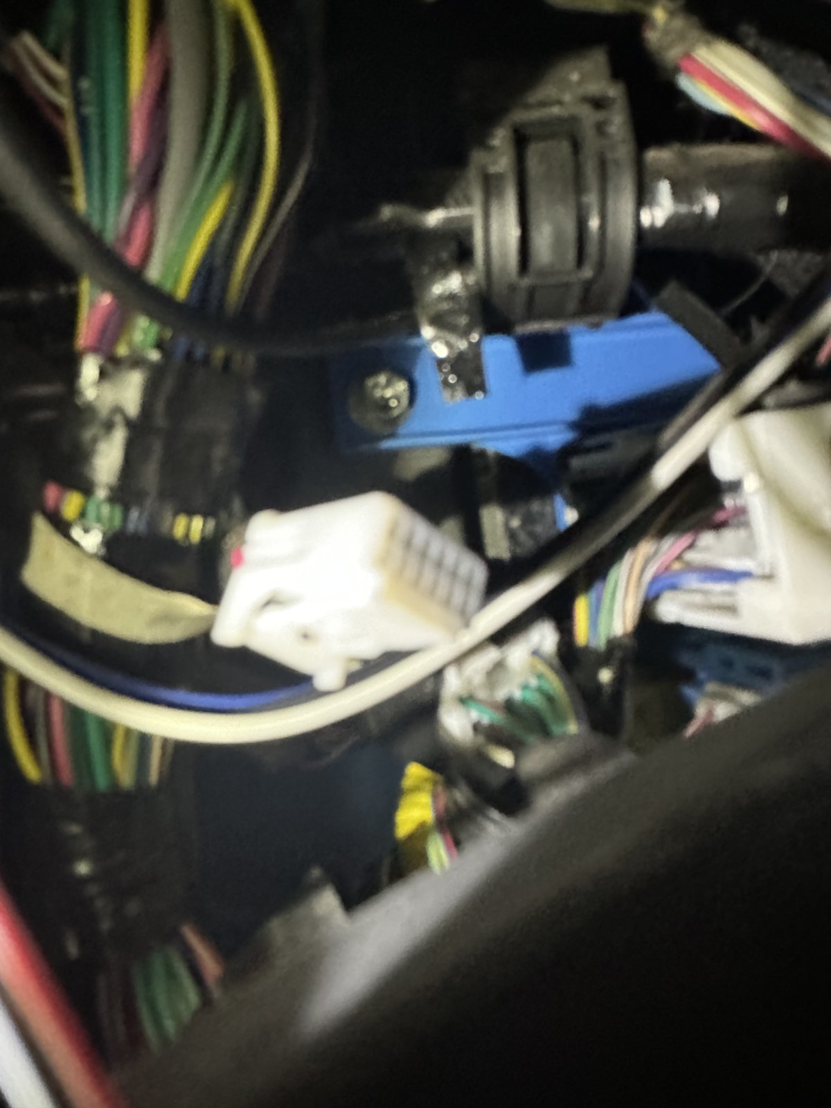

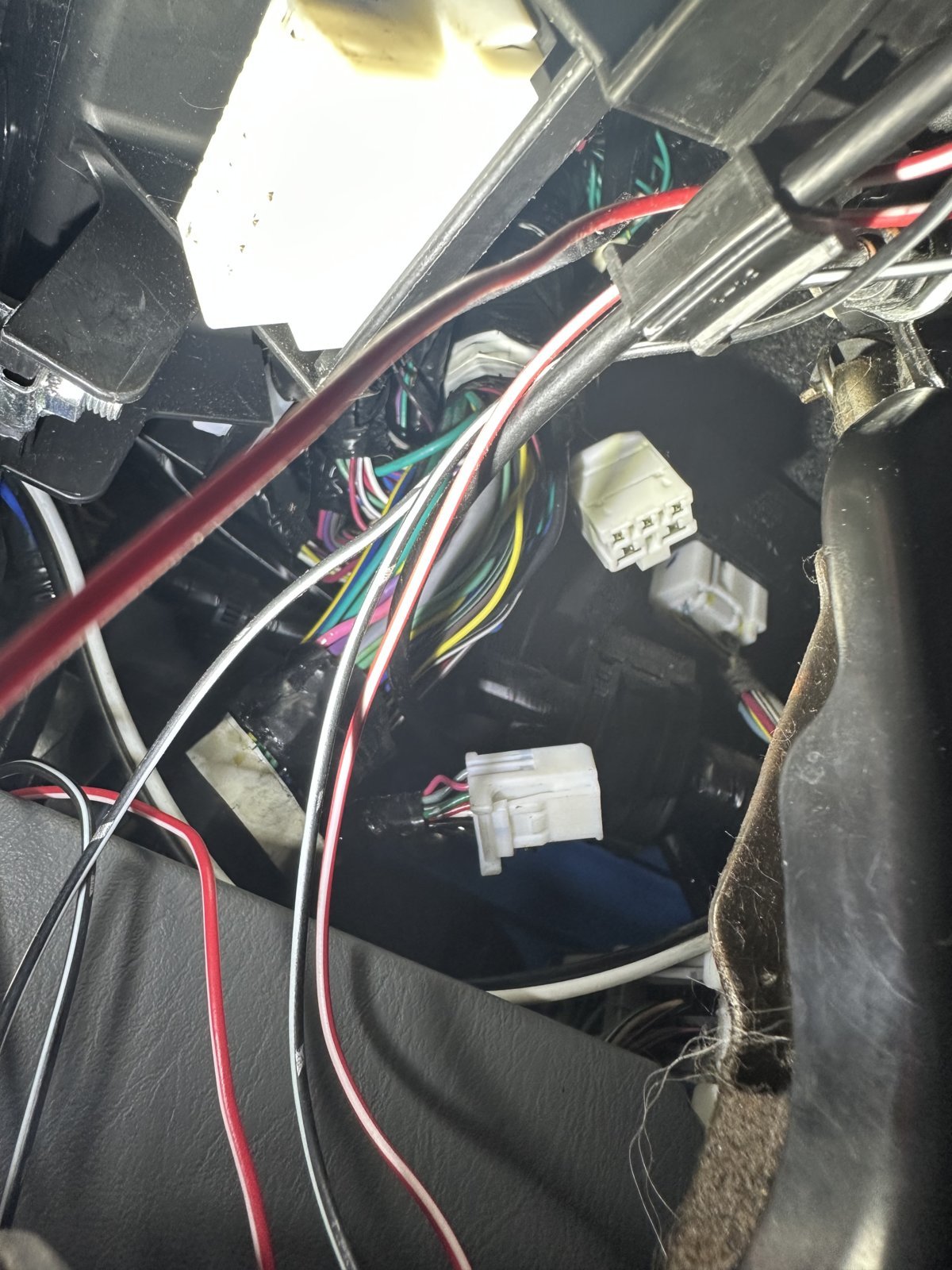

Does anyone know what accessories these two empty plugs are for?

    I’m trying to now power the turn signals on my mirrors and am hoping for a miracle with these two plugs…

    What year Tacoma is this?
    Also need better pictures of the plugs and wire colors.

    I am pretty sure the one at the top is the hookup for a brake controller
    This is the harness I bought to hook that directly to my brake controller.You will notice it has the correct shape to plug in there..

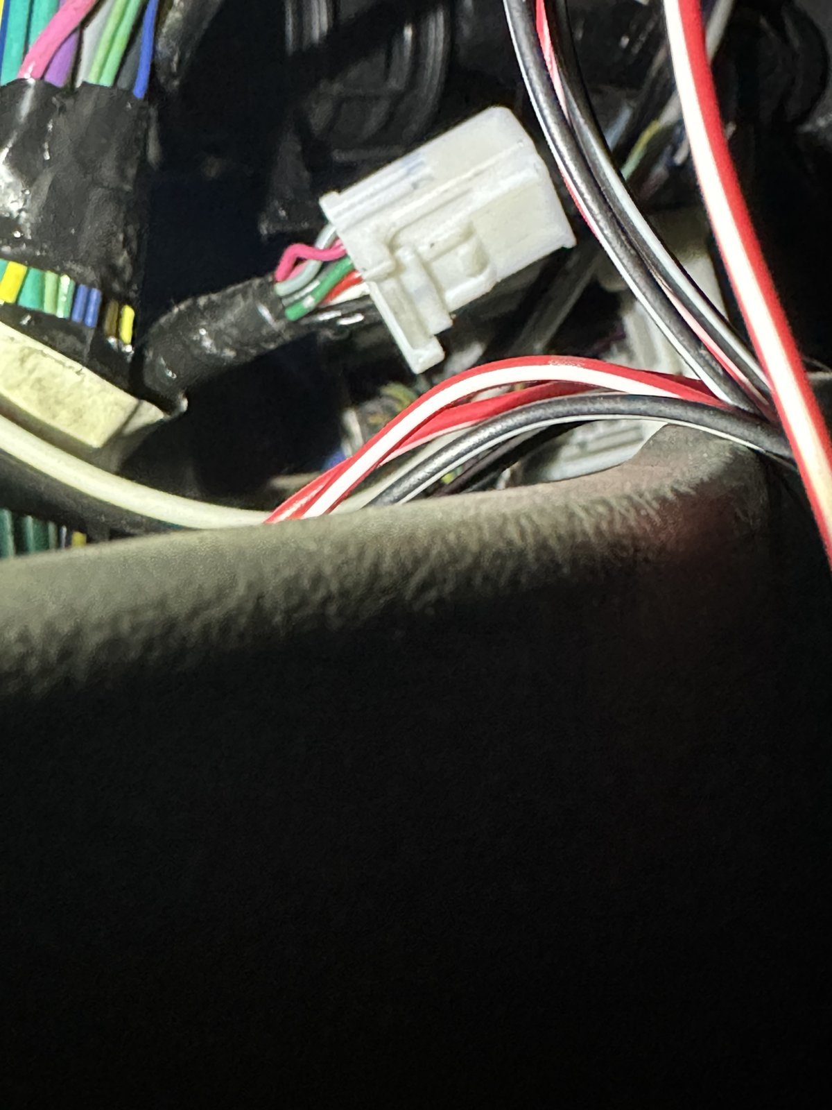

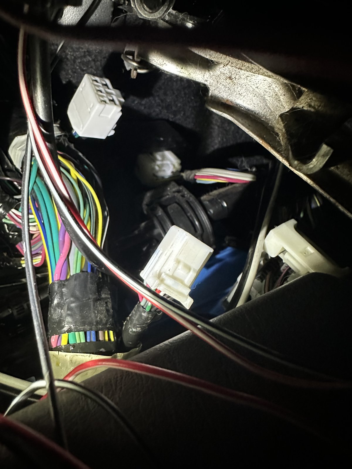

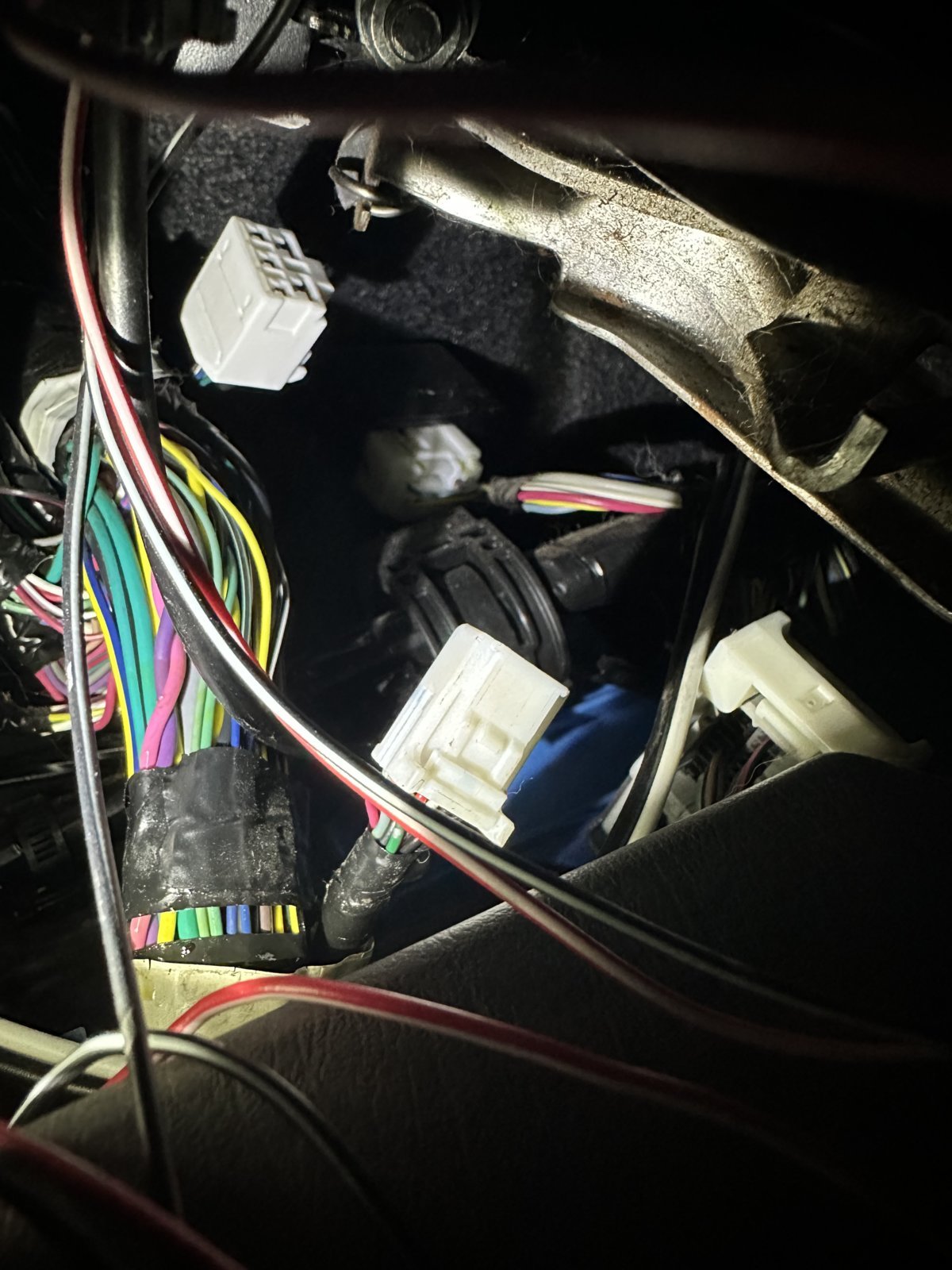

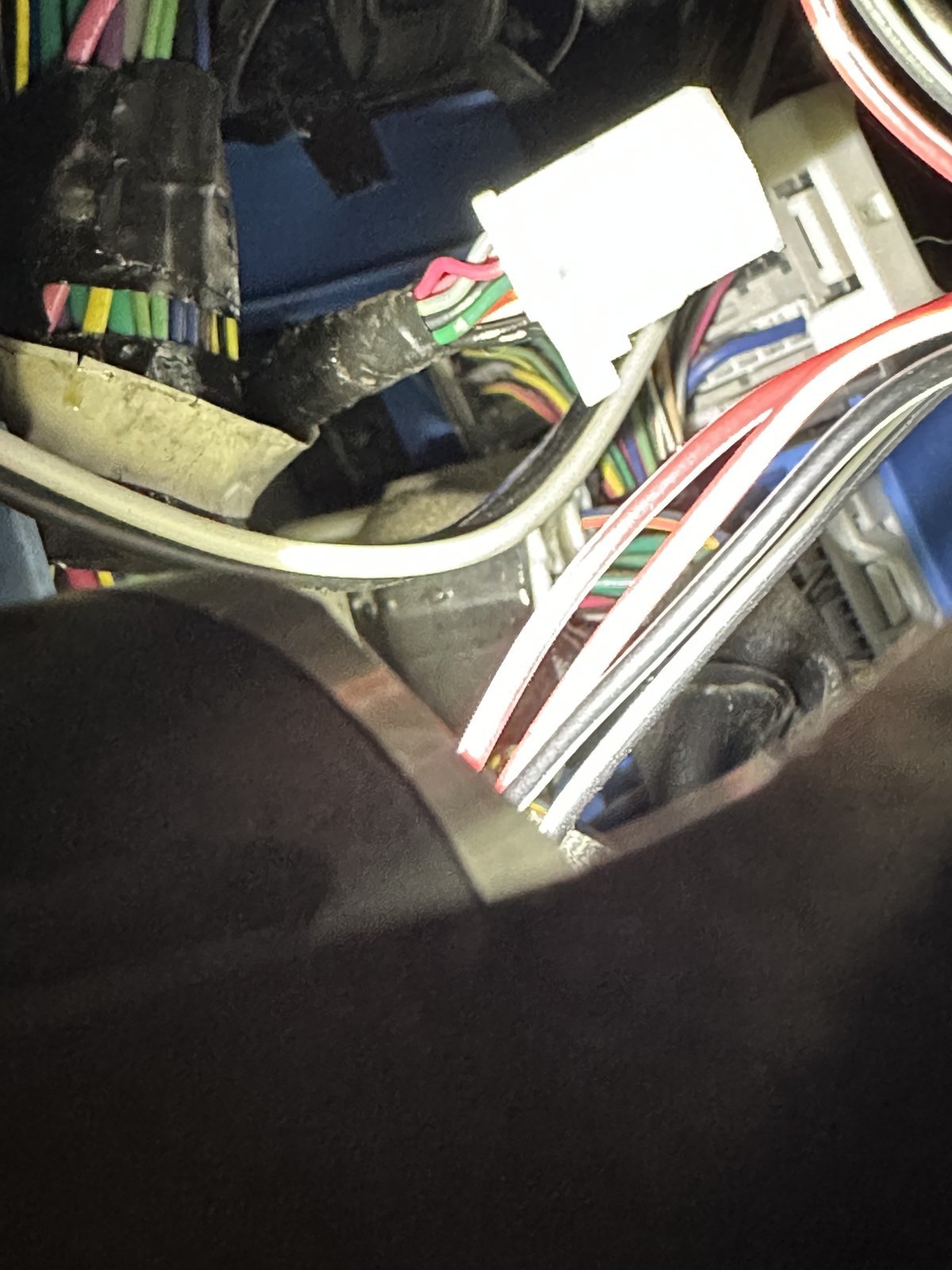

    Not an easy task.. best that I could get for my 2010 Tacoma TRD Sport

    5 pin is for a trailer brake controller
    12 pin is Option Connector Z4 for installing the XM Radio Tuner Accessory

    Wonderful help once again, thank you!
