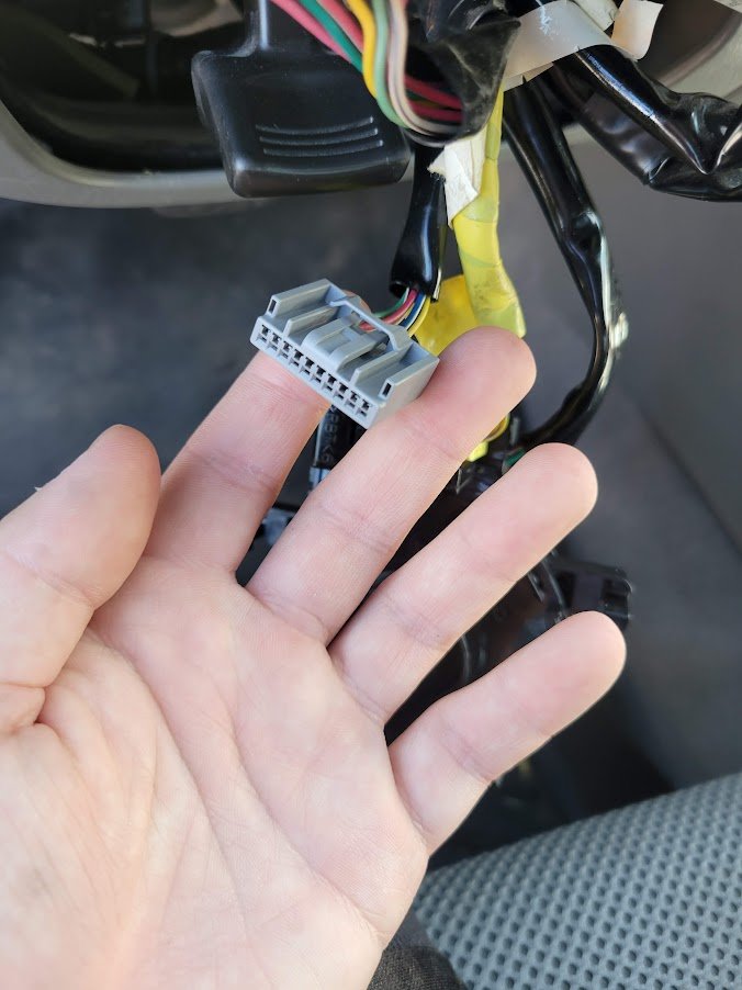

Does anyone know what this plug is for?

    I'm buying steering wheel buttons and I just installed a new clock spring. But I want to make sure this won't be some kind of issue. Thanks guys.

    Does this have anything to do with steering wheel controls for radio?

    No, no it does not...

    It's for VSC models. If you didnt swap the steering angle sensor from the old clock spring its an issue.
