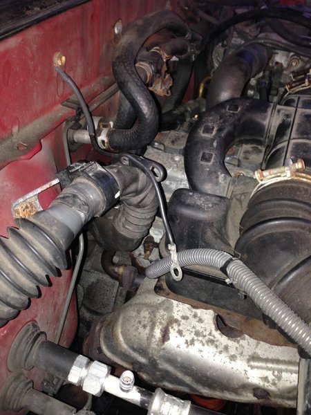

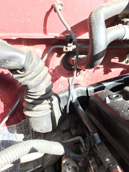

Does anyone know where this ground wire should attach?

    This is the firewall of my 2001 2.7L 4x4. I have a feeling it has been like this since Toyota replaced my frame seven years ago. So I don't think it is too critical.

    Back of the engine. Right below the cam cover. Just today I looked at mine and saw a newer type ground somebody put in that same spot.

    I actually had my intake out today and took a picture. It's a little hard to see but there is a threaded hole at the back corner of the head, just below the valve cover.

    I believe it attaches to where the wire harness is held to the cylinder head.
    The spark plugs are grounded to the cylinder head. Without this ground wire, the spark plug current needs to go through the head bolts to the block. I guess that's fine unless the other ground wire gets disconnected too.
    In any case, Toyota engineered it with this extra ground wire, so it's probably important for some reason.

    yes back of the block. Grounds the cab to the motor then motor to the battery. The hyper-sensative modules,(PCM etc) ground to the cab. While people have been getting away with it if there is any sort of resistance in the grounds there is a possibility for the PCM to not complete the drive cycle, if you have reset you CEL, due to poor ground(s). If you are wondering an ohm meter is NOT the way to check for poor grounds. I spent quite a few hours chasing crap wire and poor grounds on old Japanese vehicles... Nissans btw are the worst.
