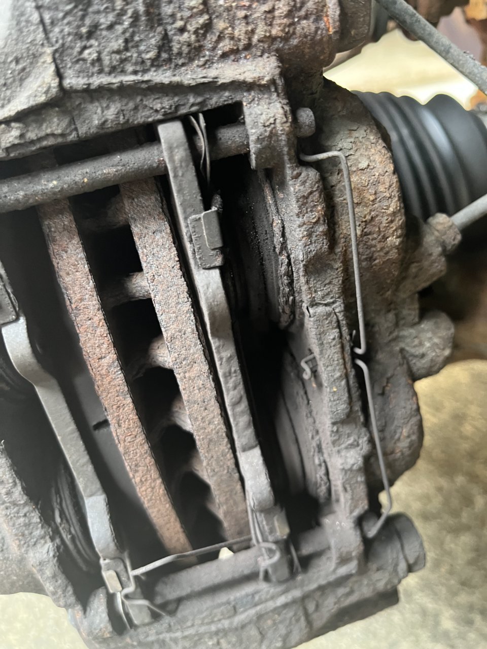

    I tore it down today as I wait for my parts to arrive. 300 miles after PA state inspection, my left front pad is totally smoked…. metal on metal! He checked off that he looked at the wheel but there’s no way! I sent pictures to my PA state inspection station to which I got a response of huh ‍♂️.
    The inner pad is slightly cocked telling me that it was hung up on the pin! I’ve got a slotted rotor kit and heavy duty pads arriving today from Advance Auto.

    Those calipers are rusty af. Make sure one of the pistons isn't seizing in the bore..

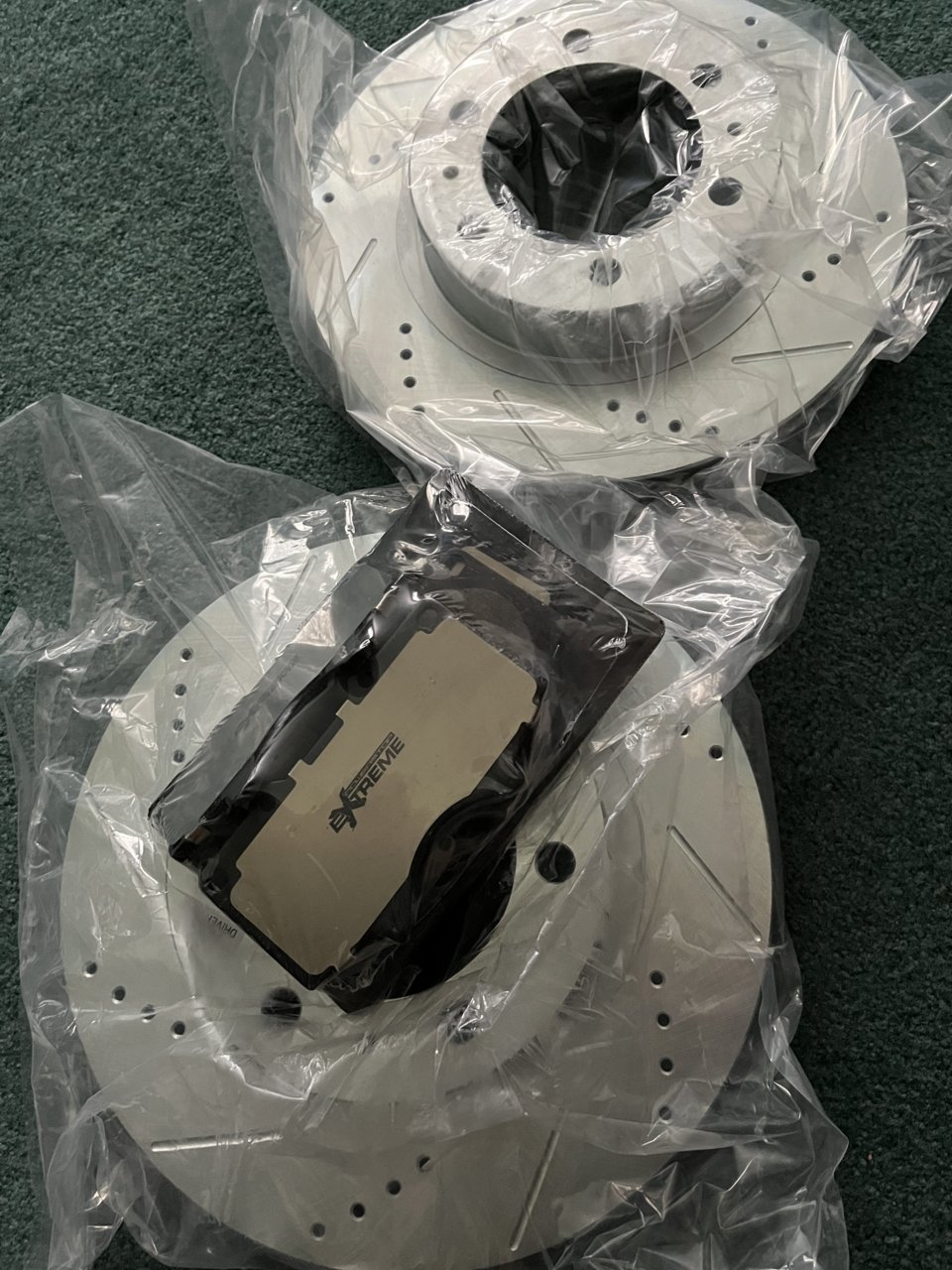

    The new shoes have arrived! Extreme Power Stop kit, pads, slotted rotors, and new pins. I didn’t know that the kit included new pins so I’ve now got 4 spares.
    Yes I will clean all of that mess up with a wire brush before I reassemble it. I’ll pull it all apart as soon as the outdoor temp and humidity is fit for a human!
