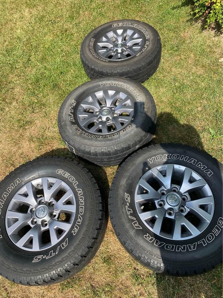

    Hello! I am looking to purchase some different rims for my new-to-me 2011 Tacoma. Mine came with some badly plasti-dipped rims. I found some locally on Facebook marketplace and I'm curious if anyone knows what year/trim these may have been from. Buyer is asking $600 for the set. Thanks in advance!

    I believe those are sr5 trim wheels from 2016-ish.

    2016 and newer SR5 is where those were available

    The tpms won’t work but they will fit for sure. 2016 sr5
    I think the price is a little steep unles the tires are in good shape

    I assumed the TPMS wouldn't work initially, but that I could have the dealer program the sensors to work. Are you saying I would need new sensors to get TPMS to work? Thanks.

    The 2016 do not work, you’ll need a new set. Or just live with the light on.

    3rd gen Tacoma's (2016+) use a different frequency for their TPMS. The OEM sensors will not work on a 2nd gen (2005-2015) no matter how hard you try.
