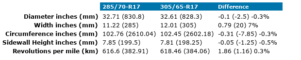

    from the online tire size calculator
    Here is a comparison to 285/70/17, they are actually shorter and wider.

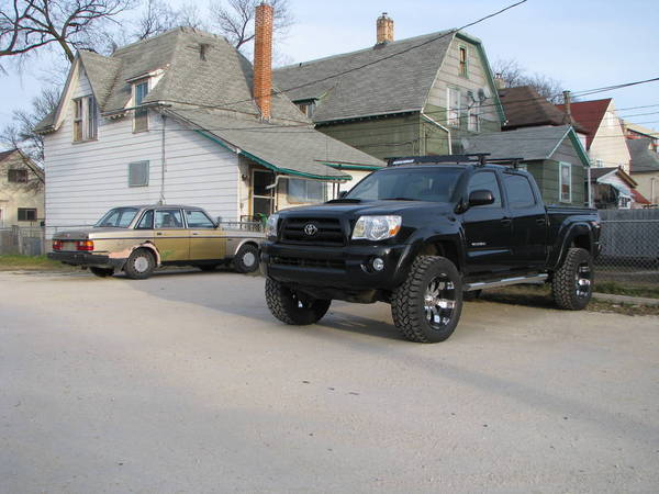

    not 17s, but 305's none the less

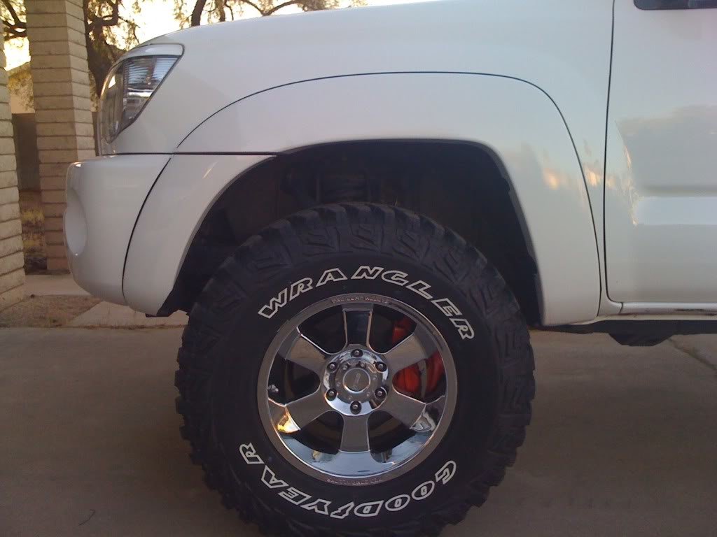

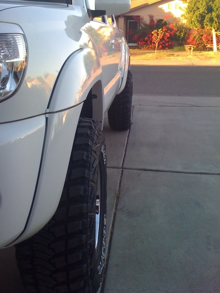

    im running 305/70/17..... i did rub quite a bit. got the body chop and no more rubbing there..... i did however have to cut quite a bit off the inner fenderwell to be able to turn full lock while wheelin and such. But nothing too crazy. im happy with my choice.
    sorry for the iphone pics but its all i got right now.

    And I run 295/70/17

    the 285's will work no question. the 305's will work also with a bit of trimming...... which is no problem at all.

    without trimming, yes.... but if youre willing to cut a little you can fit bigger.
