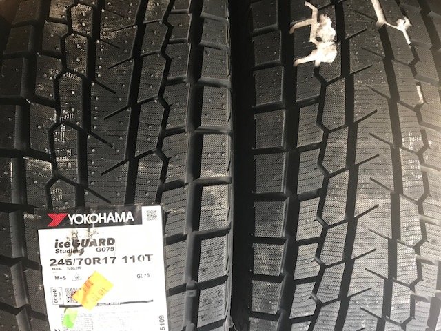

    Being from Toronto I use separate winter and summer on separate rims. But I am not going to get into the which is best for you and you will have votes for both true winters and A/T tires. The 3 peak rating to me is meaningless to me since it just means the tire is minimum of 10% (could be more) better at acceleration on medium packed snow than a reference all season (not what i call an endorsement). So you can get moving faster and then find you cant brake at the higher speed...... Tells you nothing about braking performance which to me is more important and which i use dedicated studless winter tires.
    There is a new symbol coming out which gives the rating for braking but its not currently on a lot of existing tires even though they meet the requirements.
    https://www.kaltire.com/en/ice-grip-symbol.html
    Did a quick check on https://pmctire.com/
    Where I got my winter tire/rim package and for their cheapest aluminum rim and a set of Yokohama iceGUARD G075 in your size (just because I use these) the $1780 tax included and free shipping (using the current 10% discount code on the site).
    I did not included TPMS sensors since i dont run this in my winters. Add $200 if you want them
    So if you add in the cost for a new set of summer tires at say $1000 you are only at $2700 (way less than $4000)
    My winters
    Vitamins and pbg2811[OP] like this.
