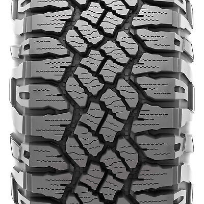

    It all come down to 3 things
    Tread compound
    Tread Design
    Siping
    The tread compound in A/T tires is generally quite tough to withstand chiping and chunking over rough terrain/rocks. And can get very hard once temps drop.
    A winter compound on the other hand would be too soft and probably shed like an eraser on rough summer terrain. But its designed to stay soft and flexible when it get cold. In this case < 7C which is the defined temperature below which summer rubber is to hard and you should be using winter. I try to swap on my winter before the daily high temp average is < 7C.
    Tread design of an A/T tire is quite open and chunky. This does lend itself to a reasonable amount of traction since it can dig through snow. But in terms of total tread surface area a winter tire will have more since tread sticks to ice, not the open spaces/voids
    Sipes open up as tires roll across the road driving surface to take in snow or water and remove it from the tire’s contact area. This enhances a tire’s grip, especially during rough weather like heavy rain or snow.
    Compare the tread surface area and siping on a quite popular A/T mentioned in this forum tire and a dedicated winter tire and these design features are quite evident.
