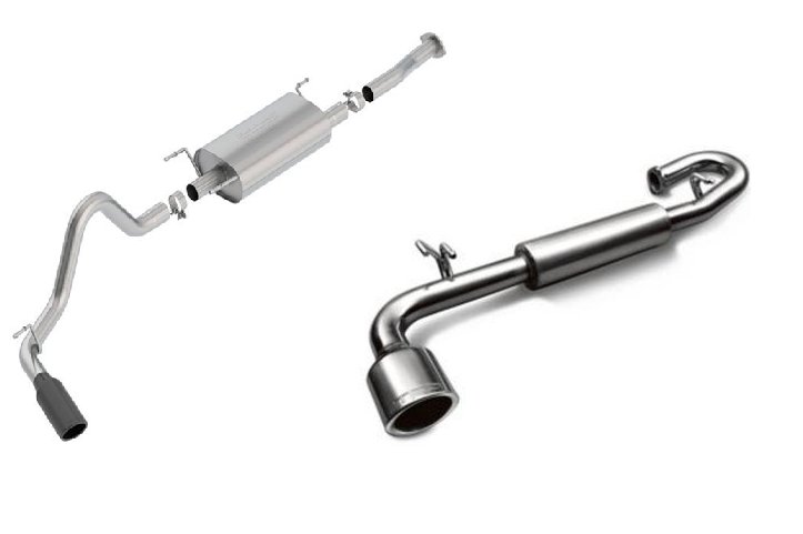

  13. May 10, 2021 at 4:52 PM
    #33
    Dawelda
    Dawelda [OP] Well-Known Member
    May 9, 2021
    #365171
    633
    West of West Phoenix
    20 Tacoma DCLB TRDOR Desert Sand
    2.5" lift w/33" tires, 10K Winch & bumper, camper shell
    So here's a question...
    I've been looking at TRD exhaust available to "fit" my truck and they all look the same. The question is why is there a "U" bend in front of the muffler? My existing system is not like this, am I missing something here? Mine is straight shot similar to the Borla replacement in the left image (TRD on right). Can someone explain this please?
  14. May 10, 2021 at 4:59 PM
    #34
    Junkhead
    Junkhead TRDude
    Feb 27, 2019
    #284671
    15,688
    Serge
    Prince George, BC
    Black 4x4 Sport MT 2018
    Some Serious Tires
    That bend goes over the rear axel. Stock should be the same.
  15. May 10, 2021 at 5:06 PM
    #35
    Dawelda
    May 9, 2021
    #365171
    633
    Noooooooooo. Mine looks like the Borla on the left. The TRD image on the right, inlet is facing the wrong direction, how the hell would it attach? And, there IS NO bend for the axle. Seriously confounded.
  16. May 10, 2021 at 5:08 PM
    #36
    Shades_Of_Red
    Shades_Of_Red Well-Known Member
    May 2, 2009
    #16713
    2,165
    Lou
    Pittsburgh, PA
    2019 Tacoma TRD Off Road Premium Cavalry Blue
    A few.
    The exhaust on the right isnt for a tacoma.
    Junkhead likes this.
  17. May 10, 2021 at 5:09 PM
    #37
    Junkhead
    Junkhead TRDude
    Feb 27, 2019
    #284671
    15,688
    Serge
    Prince George, BC
    Some Serious Tires
    Thats the TRD on the right.
    eurowner and Dawelda[QUOTED][OP] like this.
  18. May 10, 2021 at 5:09 PM
    #38
    Junkhead
    Junkhead TRDude
    Feb 27, 2019
    #284671
    15,688
    Serge
    Prince George, BC
    Some Serious Tires
    Yes.
  19. May 10, 2021 at 5:10 PM
    #39
    Dawelda
    May 9, 2021
    #365171
    633
    Thanks! Now we're getting somewhere...
    EVERY image I looked at today for Tacoma TRD exhaust had this image. I've never seen a Tacoma TRD exhaust apparently. Exhausting!!!!!!
  20. May 10, 2021 at 5:12 PM
    #40
    Dawelda
    May 9, 2021
    #365171
    633
    Son of bitch!
    Okay, that looks more like it. I hate being the new guy!:annoyed:
    And....thanks all!
