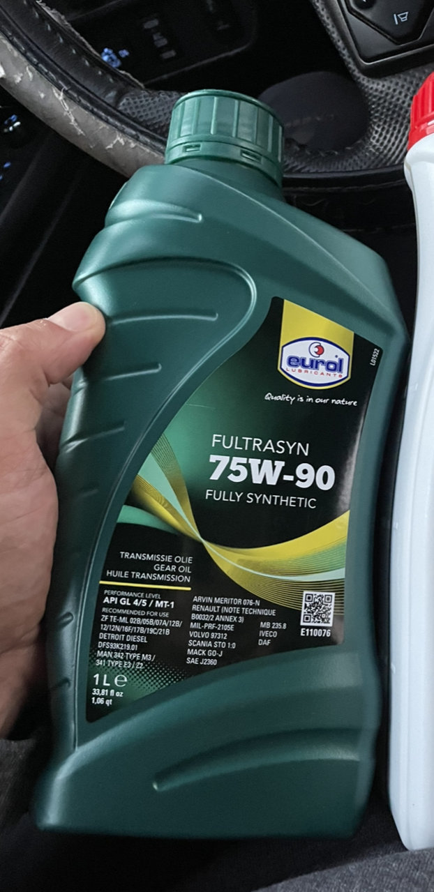

    I have access to these two gear oils. The green one is way cheaper. Is it good to use or worth the extra cash on the chevron stuff? Thanks.

    I'd use the green jug and not worry with it, as long as it meets all the specs :thumbsup:

    I don't care what brand I use, but I make sure it isn't dirt cheap. If it meets spec, it's fine, better quality stuff usually just has better additives/conditioners.
    Don't think too hard. If you use oil up to spec you're doing the right thing either way. :thumbsup:

    Googled Eurol. It’s a major Netherlands independent. Looks good to me.
    jardoo[OP] likes this.

    yeah that’s what the guy said I got it from.
    Just wanted to double check with you guys because y’all have tacomas and he doesn’t.

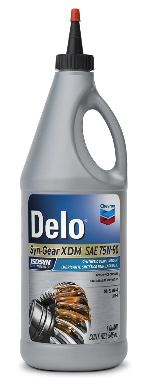

    I believe the Chevron Delo is designed for agriculture/construction/farm.
  15. Jan 10, 2023 at 9:50 AM
    jardoo
    jardoo [OP] Well-Known Member
    Mar 30, 2016
    #182793
    1,034
    Beirut, Lebanon
    2016 DOUBLE CAB MGM 4X4 TRD OFF ROAD SHORT BED
    really? What makes you say that?
    makes sense since a lot of it is being sold in bulk online.
  16. Jan 10, 2023 at 9:58 AM
    #16
    splitbolt
    splitbolt Voodoo Witch Doctor
    Mar 7, 2010
    #32761
    7,858
    NW Arkansas
    2016 TRD OFFROAD DCSB MGM
    The PDS...
    500,000 mile service interval coupled with what it's approved for...
    -Dana SHAES 256 REV C (SAE 75W-90 only)
    -Mack GO-J (SAE 75W-90)
    -Meritor O-95 and O-762 Extended Drain
    -SAE J2360 (formerly MIL-PRF-2105E)
    -Scania STO 1:0 (SAE 75W-90 only)
    -STEMCO PPS+ and PPS wheel end systems
    (SAE 75W-90 only)
    PDF download...
    https://cglapps.chevron.com/sdspds/PDSDetailPage.aspx?docDataId=406127&docFormat=PDF

    Ok this makes me feel better about getting the green stuff.
