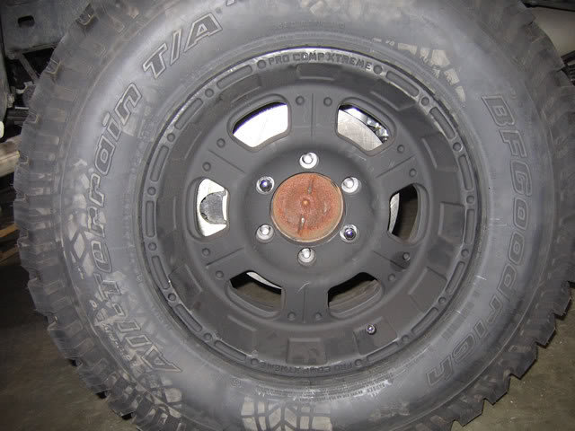

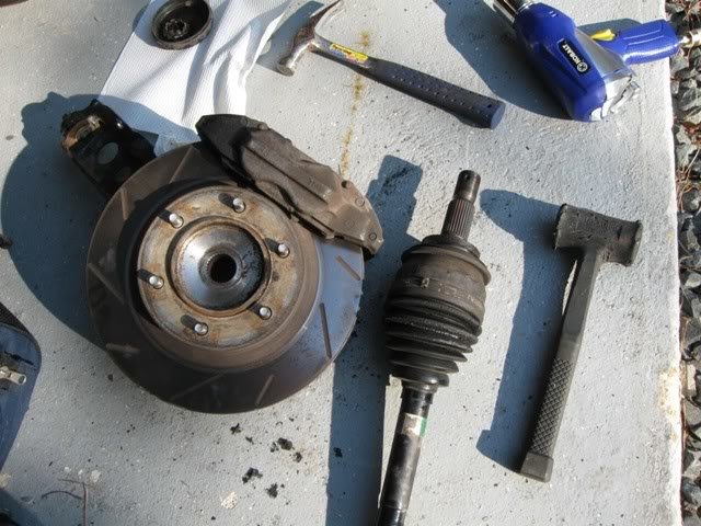

    There's a hole in the center of the wheel. If you buy the hub-centric version of the 7089s, that hole is too small to fit over the factory hub.
    The factory rims, at least 05+, are hub-centric but the hub is not a universal size. The Toyota hub is larger than center hole on the hub-centric 7089s.
    If you buy the lug-centric wheels, the hole in the center of the wheel is much larger and will clear the factory hub ring.
    The clearest picture of the factory hub ring I have available at the moment:
    Lug centric on the rear barely clears:
