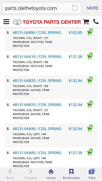

    The 16+ has different front springs side to side. They are paint marked. Think there are something like 16 different oe part numbers for front springs on 3rd gen taco. The lean comes from aftermarket springs not being side specific to account for driver and fuel tank on one side so companies like toytec make a spacer to correct this lean. My rear always has leaned a hair though and the rear springs are not side specific to my knowlege
    Just a few of the springs for the front of a 3rd gen
