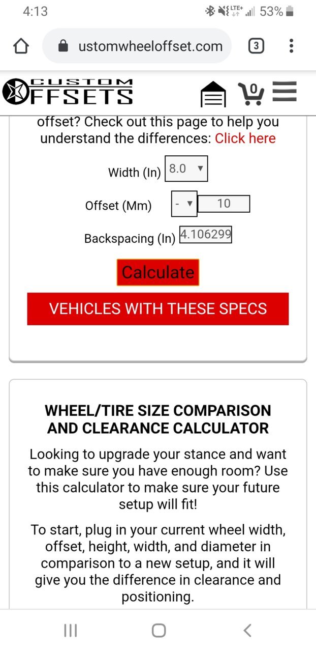

    I can’t find what backspacing my wheels are though. That’s the problem. I have the level 8 17x8 -10 offset wheels. I just don’t know what backspacing

    4.11"

    a -10 offset should be around 4.1 backspacing.

    Oh my bad. There are online calcs for that @Bertw192 hooked you up

    I have 285s w/ JBA standard high caster. Wheel:
    16 x 8
    0 Offset (which is 4.5 backspace)
    No problem at all.
    -10 offset (4.1 backspace) you should be good.
    EDIT: never mind, you need 4.25-4.5 backspace or -6 to 0 offset (based on JBA)
