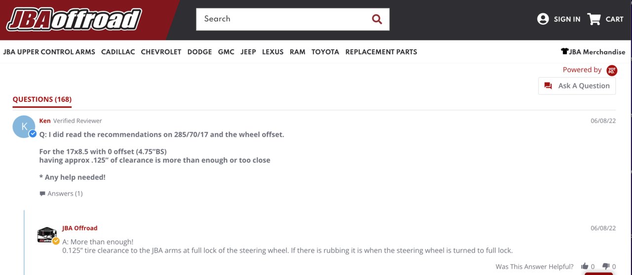

    Thanks for this post this reassures me even more. I just bought Methods 316 (17x8.5) with 0 offset (4.75" BS) and some Toyo AT3 (285/70/17) and per JBA Offroad they should clear at full lock. Here is the question I asked:

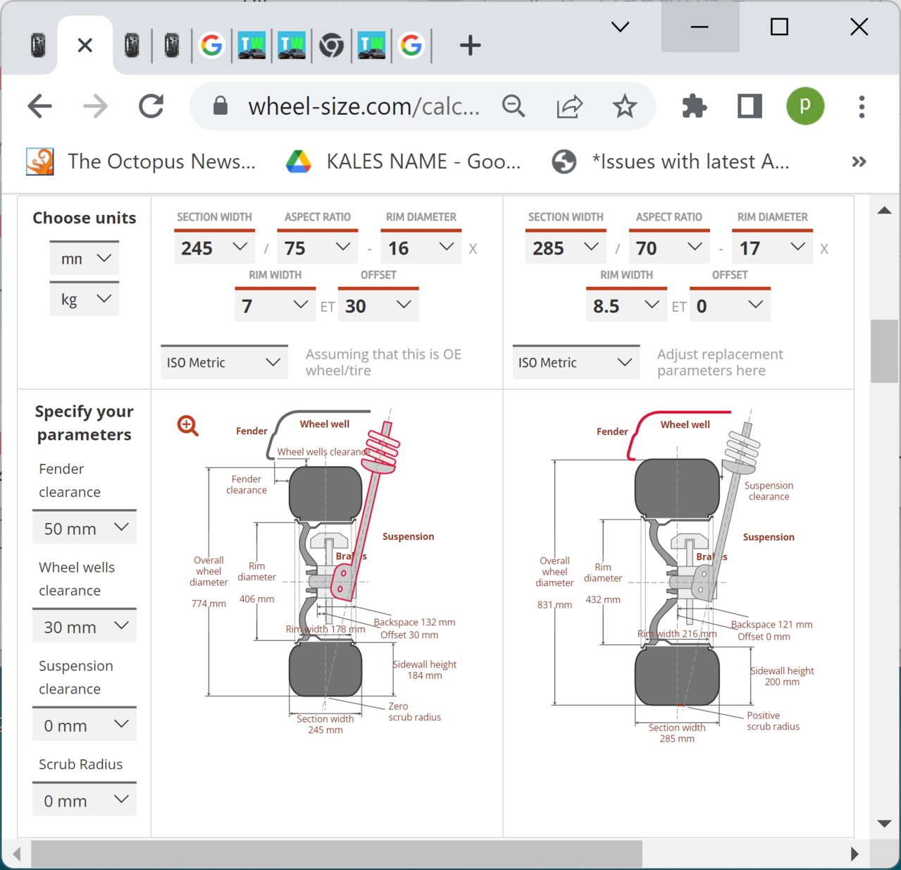

    Have wheels on order and I'm kind of panicking.
    My plan was to use 285 70 17 Wildpeak AT3W on my 2012 tacoma 4x4 with a 2.5 inch lift and JBA UCAs
    Wheels on order are 8.5 x 17 Zero offset
    JBA says they should fit...
    There website says they will fit with KO2s but also says a KO2 in that size has a section width on 11.2" and a tire site says they are 11.5"
    So If I go from a 5.18" backspace on a 245/75/16 to a 4.75" backspace on a 287/70/17 (on 8.5 x 17 zero offset)

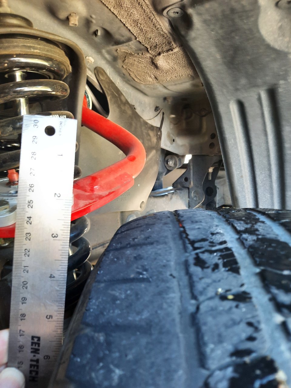

    I think the new wheel will 11 mm (0.43") less backspace (further out), the new tire is .85" wider on each side of the tire, so the new tire would be about 0.42" (7/16") closer in horizontally and will move about 1.25" closer vertically
    Based on the picture below, no way ibn hell that will fit
    I could try to reorder the wheels with a -18 offset but I am not convinced that would help.
    Am I missing something?

    One problem that was bugging me with JBAs recommendations were that it assumes all tires of 285/70/17 are 11.2" width and if you go to the specific tire manufacture's website (including BFG KO2) most 285/70/17 are 11.5" in width in terms of All-Terrain. To answer your question. Mathematically speaking: No the 11.5" width tire of sizes of 285/70/17 will not fit with a 17x8.5 & 0 offset wheel.
    This is simply my speculation. If anyone with these specs can chime me in please do so since on the same boat

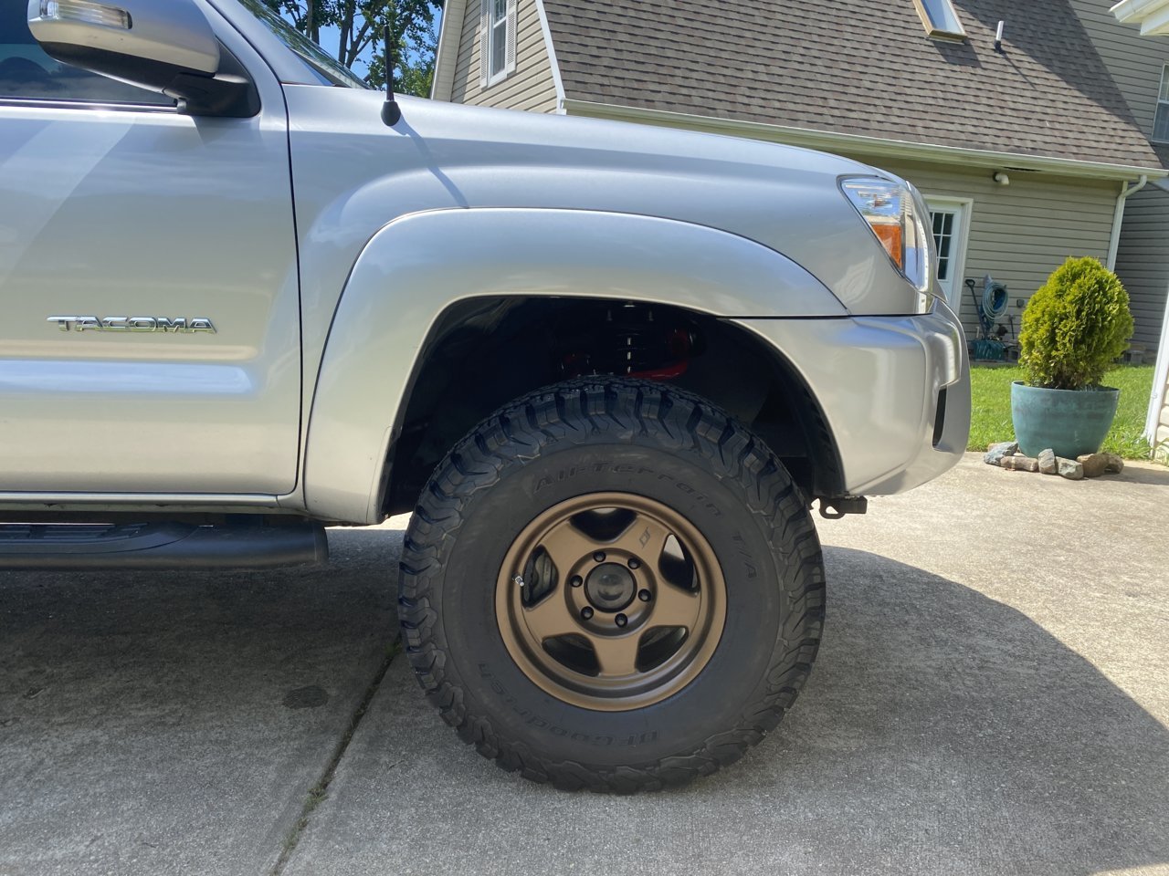

    2013 Silver Tacoma TRD Sport DCLB

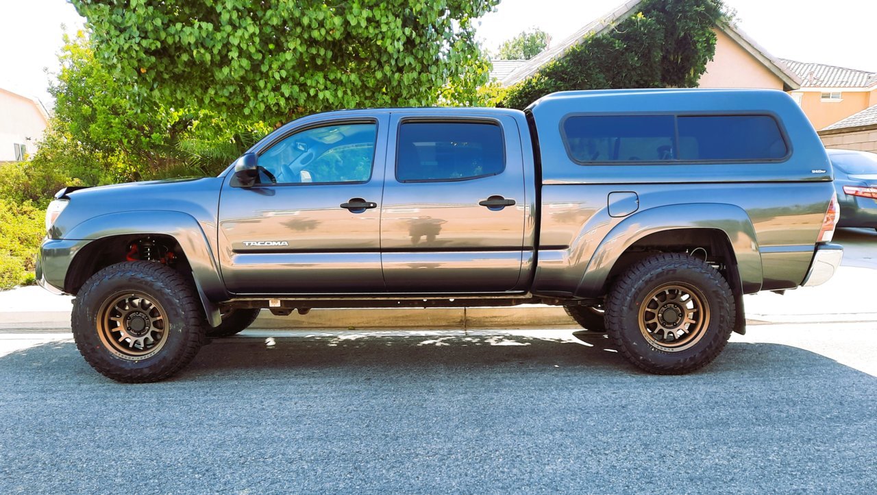

    Don’t know if this will help but I just installed a very similar set up on my 13 TRD Sport.
    My wheels are 8 x 16 with 0 offset 4.5 backspacing and I have 285 75 16 KO2s.
    Suspension is Biltstein 6112/5160 set to 2.5in and JBA UCAs.
    I went with 16s for the whole “more tire, less wheel” appeal.
    There is no rubbing on the UCA, there is plenty of room. I don’t think you’d have any trouble with the 8.5 wheel. Had to remove all mudflaps. No issue rubbing so far but it is close and I could see rubbing occurring at full turn in off-road environments.
    kbecerra and pfoxgrover[QUOTED] like this.

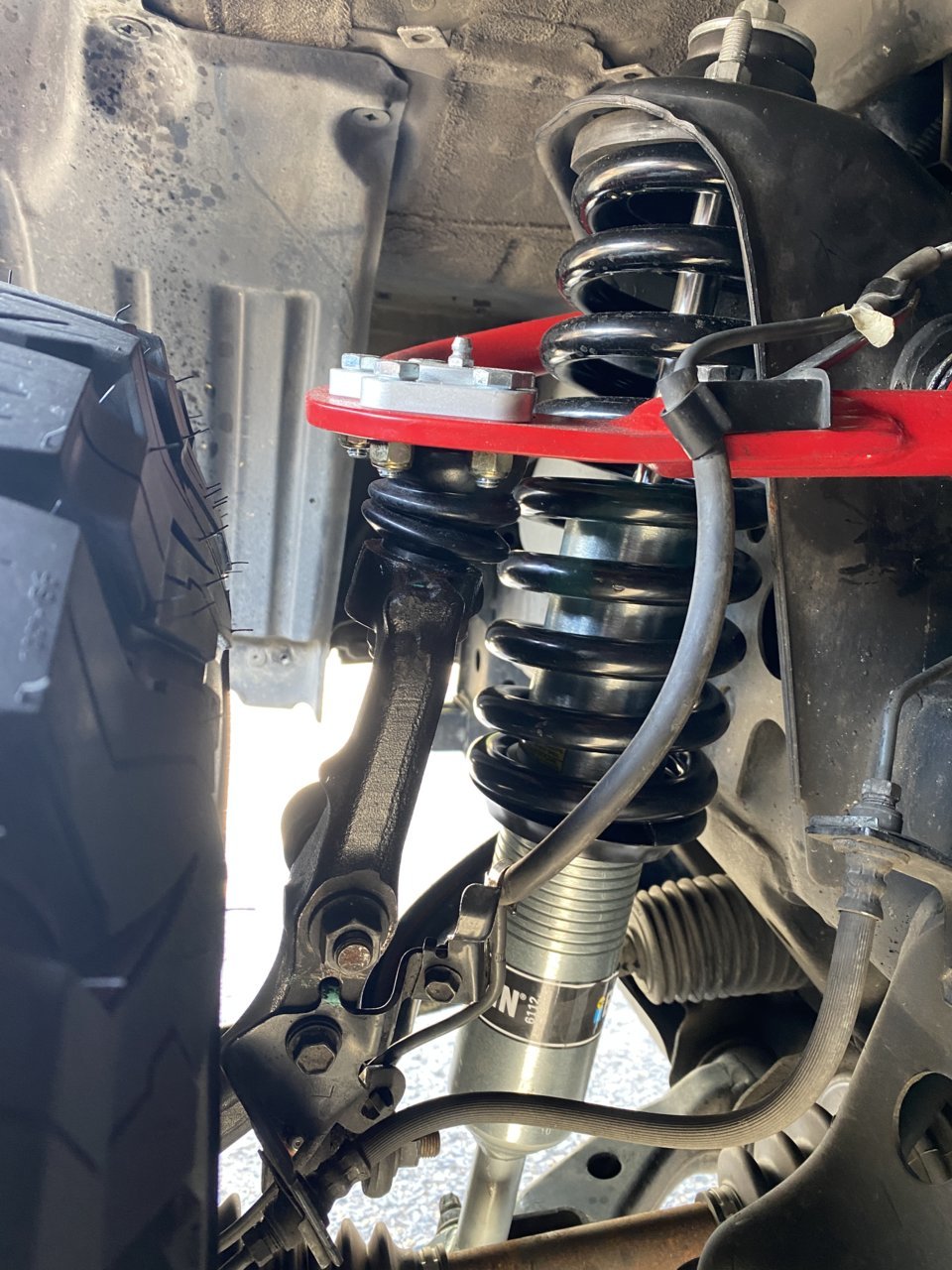

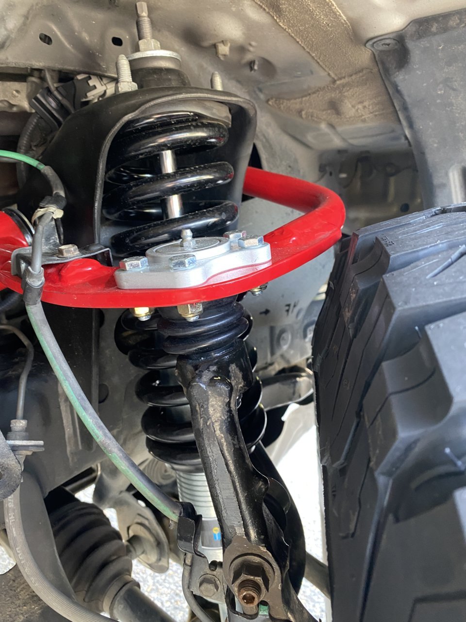

  15. Jun 10, 2022 at 3:29 PM
    #35
    Abebaca
    Abebaca Member
    May 29, 2022
    #398267
    6
    Driver side full right turn
    Passenger side full left turn
    front clearance at full turn
    Rear clearance at full turn
    Straight
    As you can see with my set up, I’m definitely going to have some rubbing in off road conditions at slow speeds and maneuvering obstacles. I’m not planning on doing much of that so I should be ok for daily road driving.
    I’m not sure how much of a difference the set ups y’all are trying to run would be compared to this.
    kbecerra[QUOTED] and pfoxgrover like this.

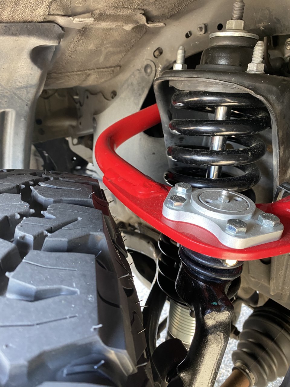

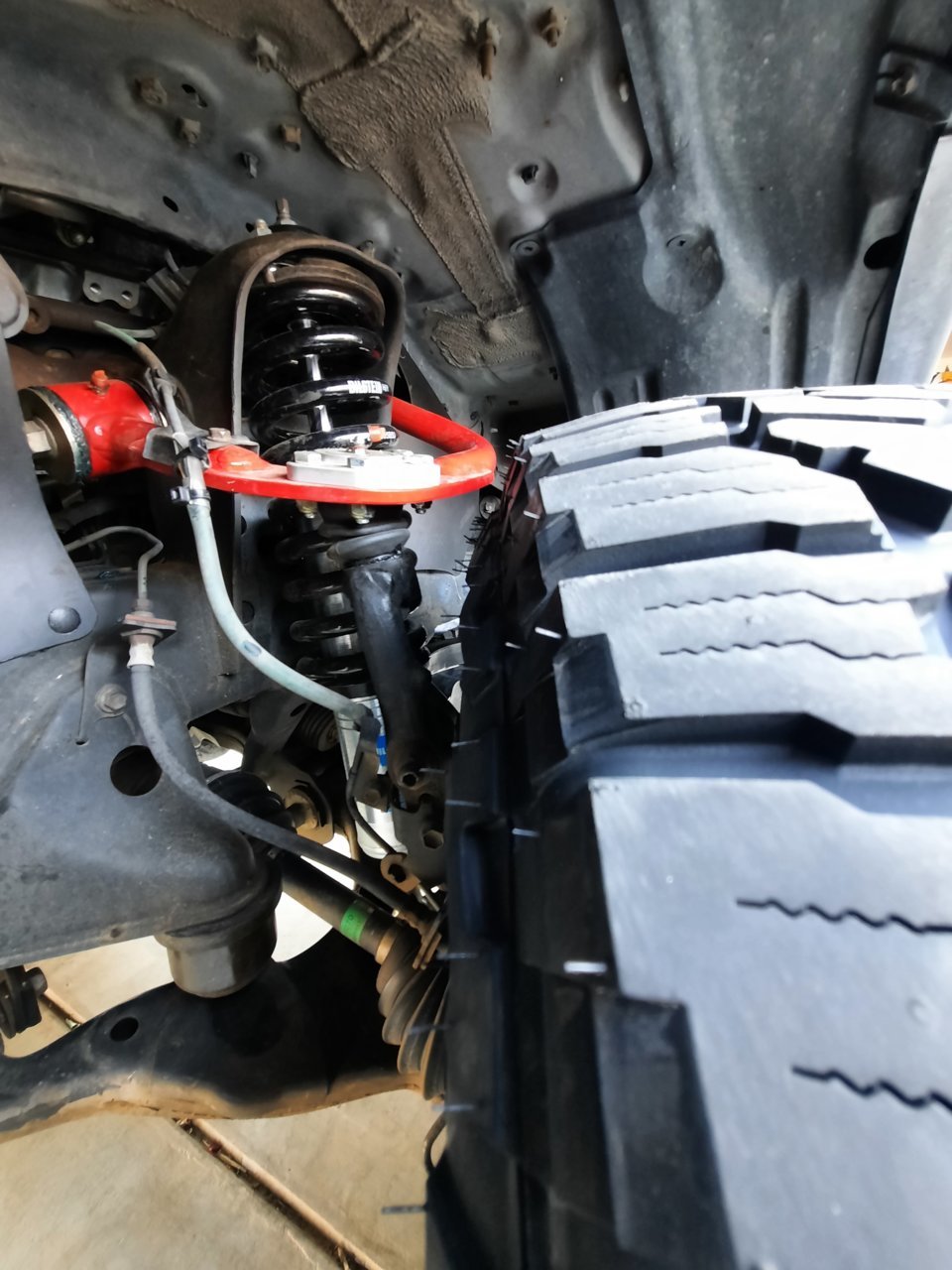

  17. Jul 24, 2022 at 1:22 PM
    #37
    pfoxgrover
    pfoxgrover Well-Known Member
    Jul 4, 2018
    #258352

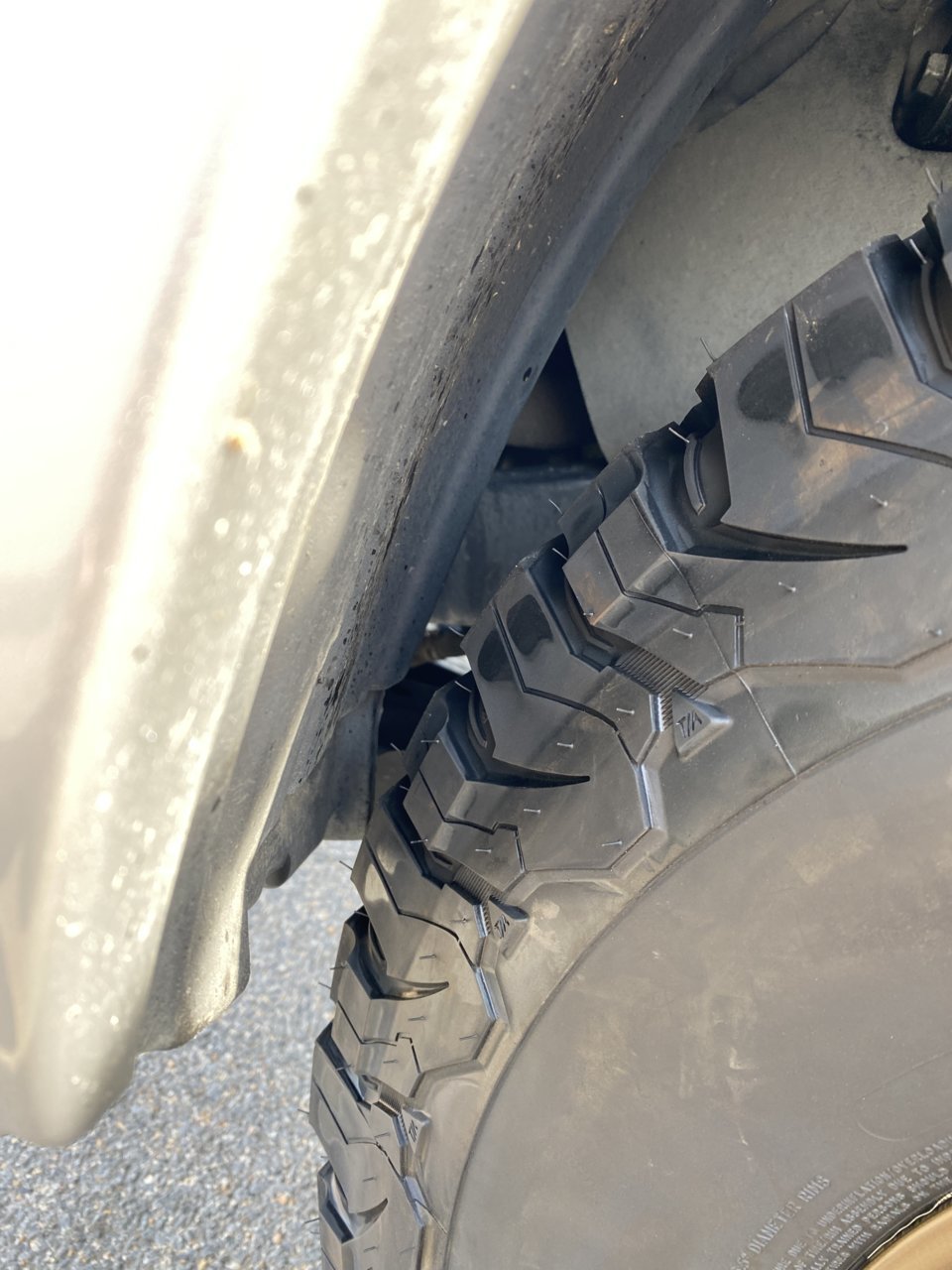

    66
    Update: I got my Falkon Wildpeak AT3W P285/70R17 installed with my JBA UCA and 8.5 inch 4.75 backspace wheels and as predicted by JBA they clear. This picture if almost full lock. With the steering wheel 100% turned and held there (although I didn't take a picture), it still cleared by almost 1/8".
