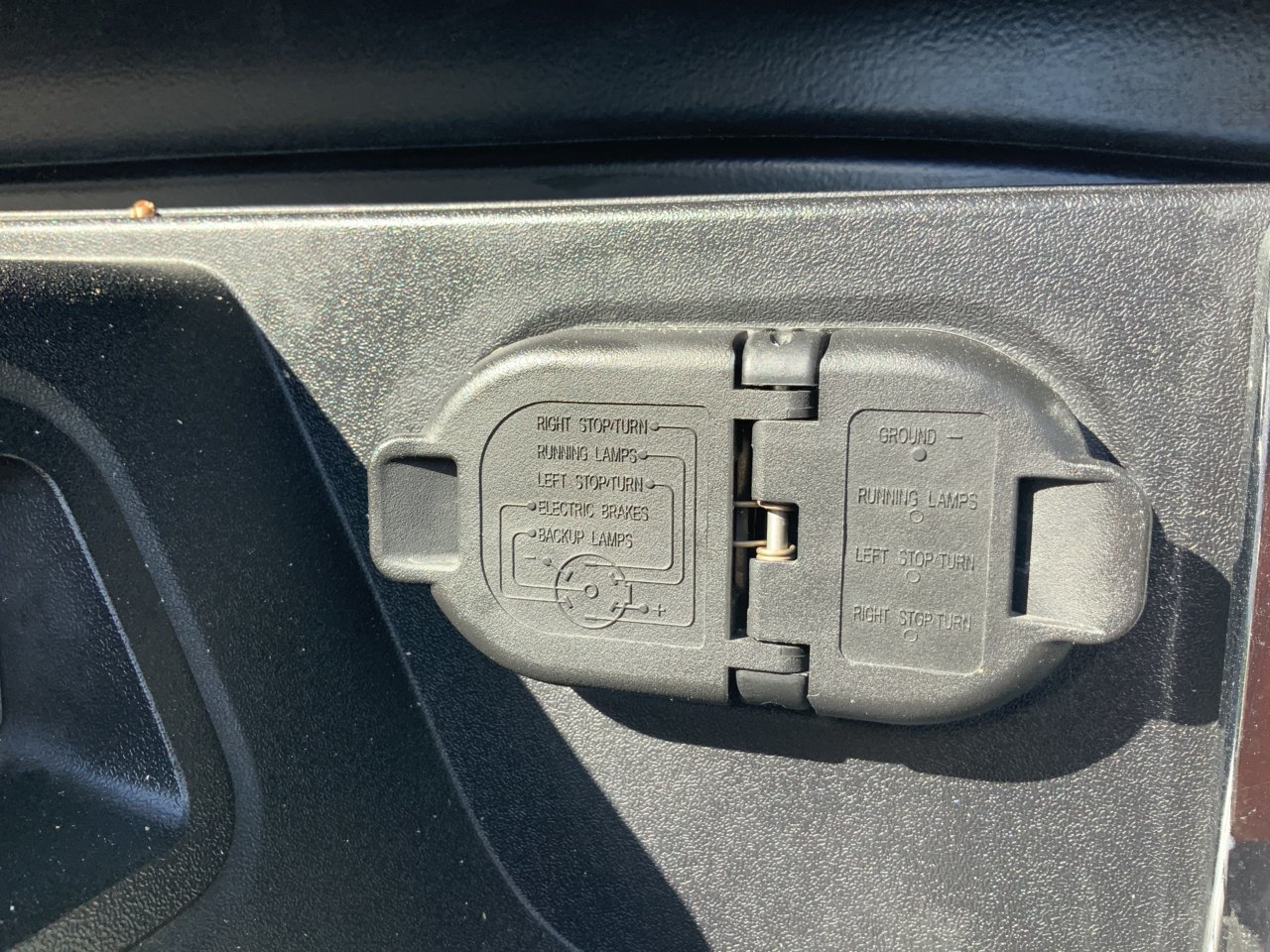

    To be fair, it does have "a" tow package, just not "the" tow package. I mean you can tow with it as it sits. It might be lacking in some areas. You will need to look into the wiring to see if it is a 4 way or 7 way wire. 4 way is just left, right, brakes, and running lights. 7 way is what you would need for electronic brake control. Personally I will never tow anything heavy enough with my Tacoma to need brakes. You just don't have enough truck.
