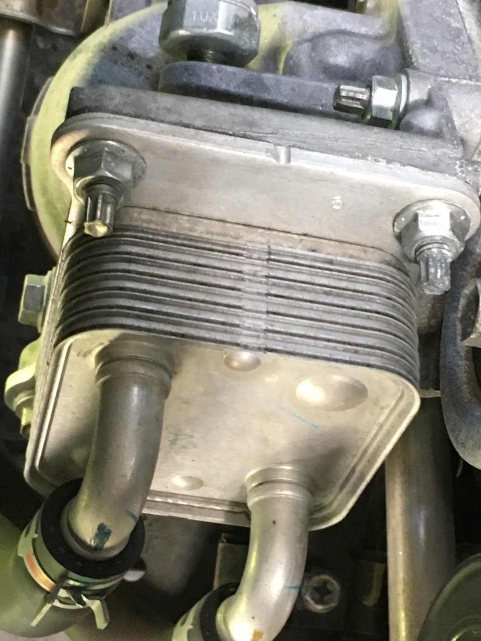

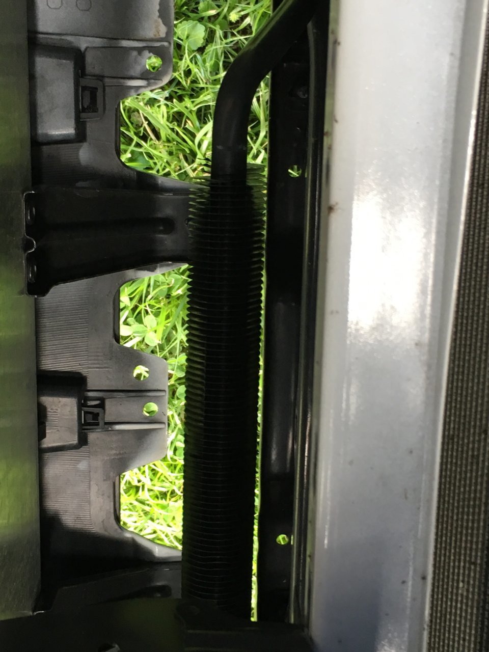

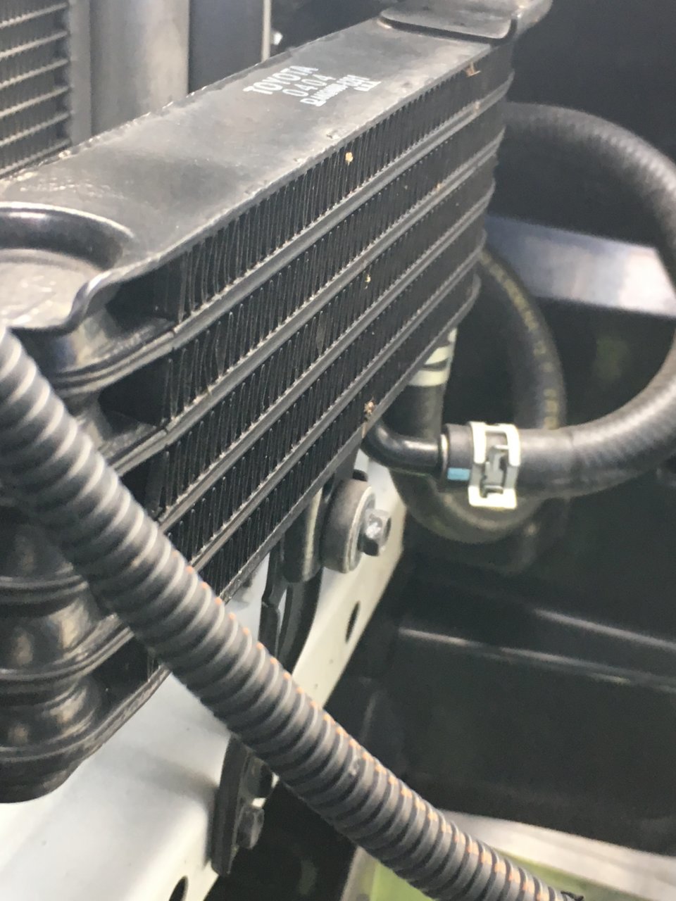

  4. Jun 4, 2018 at 1:01 PM
    #24
    Ronzio
    Ronzio Well-Known Member
    Feb 20, 2018
    #245114
    2,719
    Pennsylvania
    17 DCSB TRDOR
    I believe these 3 are oil, trans and power steering coolers. I have the factory tow package on my 17.
    FFA3BDC5-EBF4-427D-BF4C-FEE73A2F1594.jpg 51D0ABE4-9993-4544-B4CA-F9F1283AC6D3.jpg 545614E1-DF87-43D2-9473-B4530F2FE5EE.jpg
    Riding Dirty, FJ to Taco and dpippel like this.
  5. Jun 4, 2018 at 1:12 PM
    #25
    STexaslovestacos
    STexaslovestacos Well-Known Member
    Dec 27, 2016
    #205817
    434
    Sam
    2017 MT TRD OR
    It's the finned tube that runs by the radiator.
