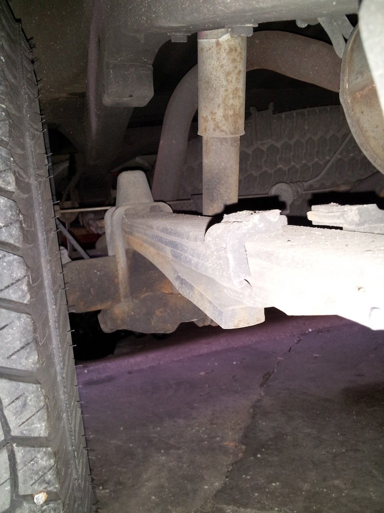

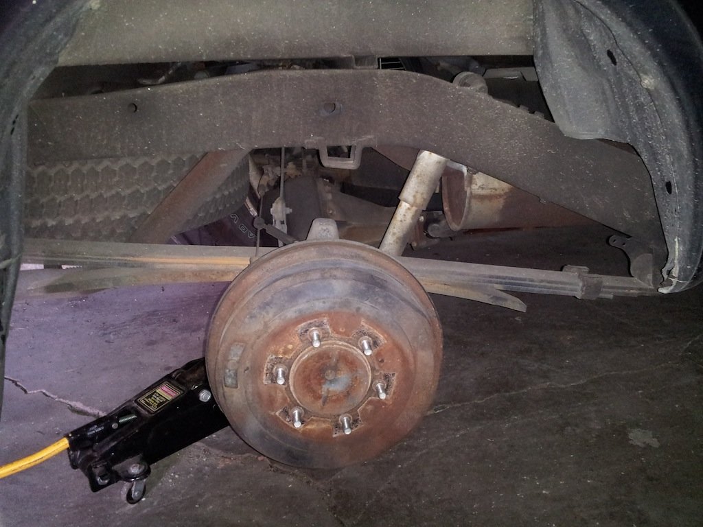

    Just on my own, I'd assume yes, but then I've never seen what fresh leaf springs on a gen 1 "should" look like. I've gotten some good info here about lifts, etc., but this is a Prerunner that is used for utility only - mainly house rehab stuff. In other words, I don't need to lift it, but if new springs and shocks would improve the ride, my wife would be happy, as she drives it once a week. And speaking of shocks, the current set of KYB gas-a-just shocks probably could stand to be replaced too. They're about the rustiest things on the truck.
    Anyway, your thoughts on the leafs?

    Mine have looked like that for at least 5 years now.

    YES... That is way past flat lol. Thats like hyperextending your knees

    Mine look like the OP's at 60k miles. New leafs are in my future though.

    You've got some linear deformity but they're not trash yet, I wouldn't throw a lot of money at a new leafpack unless the mains were bent right before the eyeletts, couple chevy springs or even over the counter AAL would turn that spring into a little positive ARC & would vastly improve the ride, & sadly, no replacing this spring with new stock springs would be a HUGE waste of $$$$ Because they'll look like the old ones within a year or so....

    Look pretty flat to me! The springs on my 02 looked the same, I just put on ome springs and they are aweeeeesome
