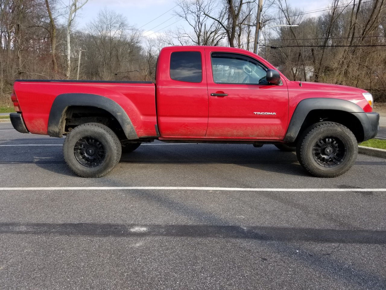

Does my Lift look off?

    3 leaf AAL packs will give you a solid 3" lift in the rear if you leave the overload leaf in, happened with my 3 leaf AAL from HS too.
    If you plan on running with any weight in the rear, you should keep it as is because AAL packs aren't designed to perform great with a lot of weight like an upgraded HD leaf pack would. I have a bed rack and RTT over my bed now and the 3 leaf AAL holds it ok as is, but if I throw another 50 - 100lbs worth of gear in the bed it starts to sag pretty bad.

    Generally leaving the overload in results in 2" of lift on a second gen. 1.5" without the overload.

    If you did a single AAL your rear would be an 1-1.5" taller not 2", and you'd be evened out a bit more.

    ...Unless you had a 2" single AAL.
    Op - It sounds like you are going for a specific ride height. And you do look a little ass high. First, you need to know where you want to be. Factory rake is typically ~2". Meaning the rear is 2" higher than the front. One of the more common lift setups (to level it out more) is a 3/2. 3" in the front, 2" in the rear. With this setup, you lose 1" of rake, which makes it look more level, without giving you the squat look, or "Bro Lean" (rear either dead level with, or lower than the front), and still being functional as a truck.
    So, take measurements from center of hub, to the bottom of the fender front, and back, and let us know what you have, and where you want to be. Then you can decide what to do (that pic you posted looks like you have at least 4" of rake to me).

    I thought the 3 leaf progressive AAL is only 1 1/2 “ of lift with stock overload leaf removed ?

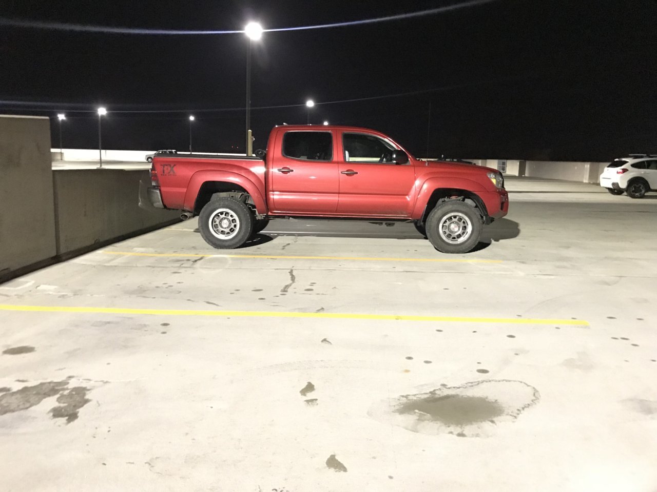

    I like the look...this is pretty much the intended rake for TACOs in my book, to each his own. But yes it looks normal. Rear leafs tend to settle more with time vs. coils in my book, plus it is a truck so you put load in back and it performs well under load. Lastly, it's up to you. My 2 cents:
    Here's mine, clearly raked:
