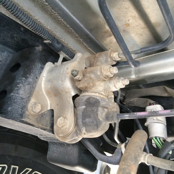

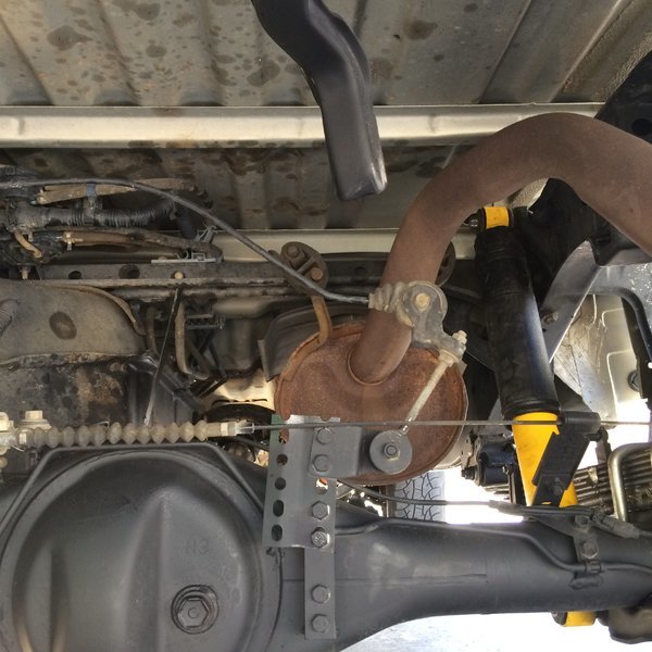

    Truck came with a 3" block/spacer lift. When I put on my OME kit I added the ugly bracket you see that it's bolted to.
    The more I look at it, the more I think the PO already had a bracket in place. Should I lose the bigger bracket I added?
    While under there I saw this bleeder valve. Never touched it. Does it need to be bled along with the brake bleeder valves at each wheel?

    Yes there was already an extension on there.
    As long as you bleed each wheel real good no need to bother with the valve.

    I adjust the arm on mine based on how much rear braking I get. And the only real way I've found is at or near lock up, both fronts and rears. Easier to do on gravel/dirt. If the rears lock up first, before the fronts, lower the arm, one notch and try it again. Work your way down until you find a balance. That is my MO.
