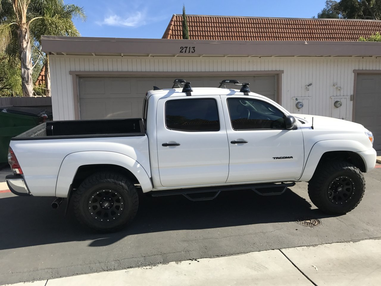

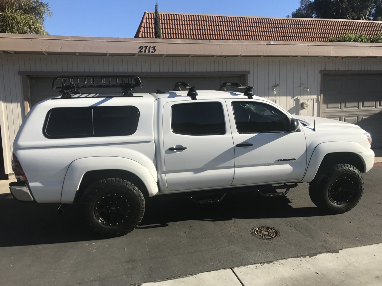

    Yes you will for sure have sag with how heavy they are. Meaning your rear bumper will be lower to the ground for less clearance. You can tell in these 2 pics of my 2015 SR5. Look at the difference in space from rear tire to fender.

    Oh yeah, it’s quite noticeable in that picture comparison. Good to know. Sick truck btw

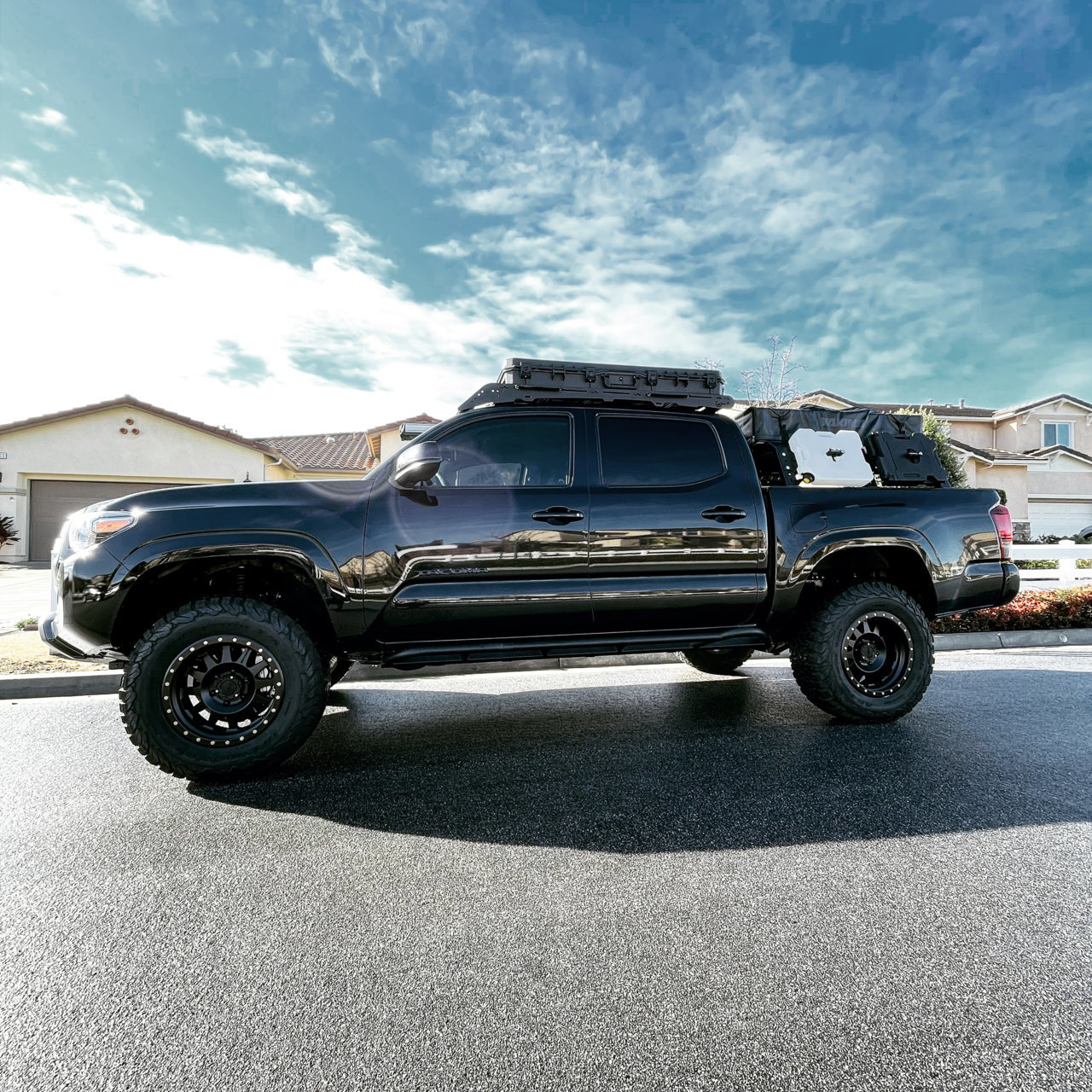

    Thanks man. I miss it but am loving building my new 2021. So this time right at the beginning I just did the HeadStrong progressive aal for that 1.5” to make up the weight difference in the back. And when I get new coilovers up front, I’m going to add the 1/2” shim to the aal to get the full 2” in the rear. So if you’re planning on leaving a shell on, for sure do a new leaf pack or aal at minimum if you don’t wanna see sag.
