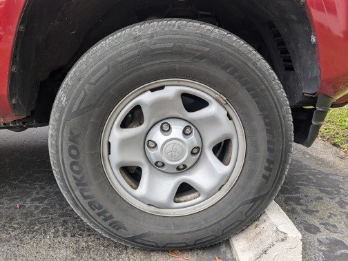

    I have a 2019 Tacoma SR Access Cab that I haven't driven much since I bought it new, and now my tire pressure warning light is coming on even though the pressure is good in all of my tires. Apparently the pressure sensor batteries are failing, which makes sense since the truck is 6 years old. The tire tread is still good so it looks like I'll have to have the sensors replaced even though I don't need new tires.

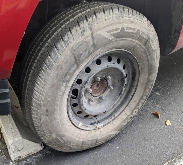

    My spare tire is the same as the other four but the wheel is different. It's black with several round holes instead of the usual silver color with five spokes, and has a sticker that says "Temporary use only". Is that because the spare has no pressure sensor? If not then what's the reason?

    No, the truck can only store 4 sensors at a time. The spare is just a regular valve stem.

    Okay, thanks! I was upset when I found the spare had a different wheel, but since the "TPMS" is considered a safety feature my guess is that Toyota did that to discourage driving on a tire that has no sensor.
    At any rate, I have a stock wheel like the one in the attached photo coming from a seller on eBay and I plan to have my spare tire mounted on it, so I'll have two choices: I can have my sensors replaced, or I can put up with the warning light until the time comes to replace my tires. According to research I did, I can't kill the dashboard warning light without taking the dashboard apart and cutting a wire.
