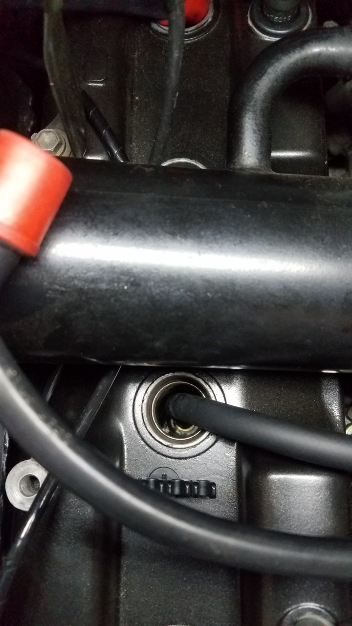

    New problem. I cant get the hose out of the hole. The hose is just spinning inside the fitting that's screwed into the plug hole...
    Freaking HF tools...

    Can't you use a socket to get the fitting out? If I recall I needed a deep 18mm (?) socket to fit on the piece that screws into the spark plug hole. It was a tight fit.

    I've tried pulling up and turning, pushing down and turning and the hose just spins inside the fitting

    FU compression tester. I WIN!
    Had to go buy a looong skinny screw driver to get down the hole occupied by the hose and was able to get the round fitting to loosen.

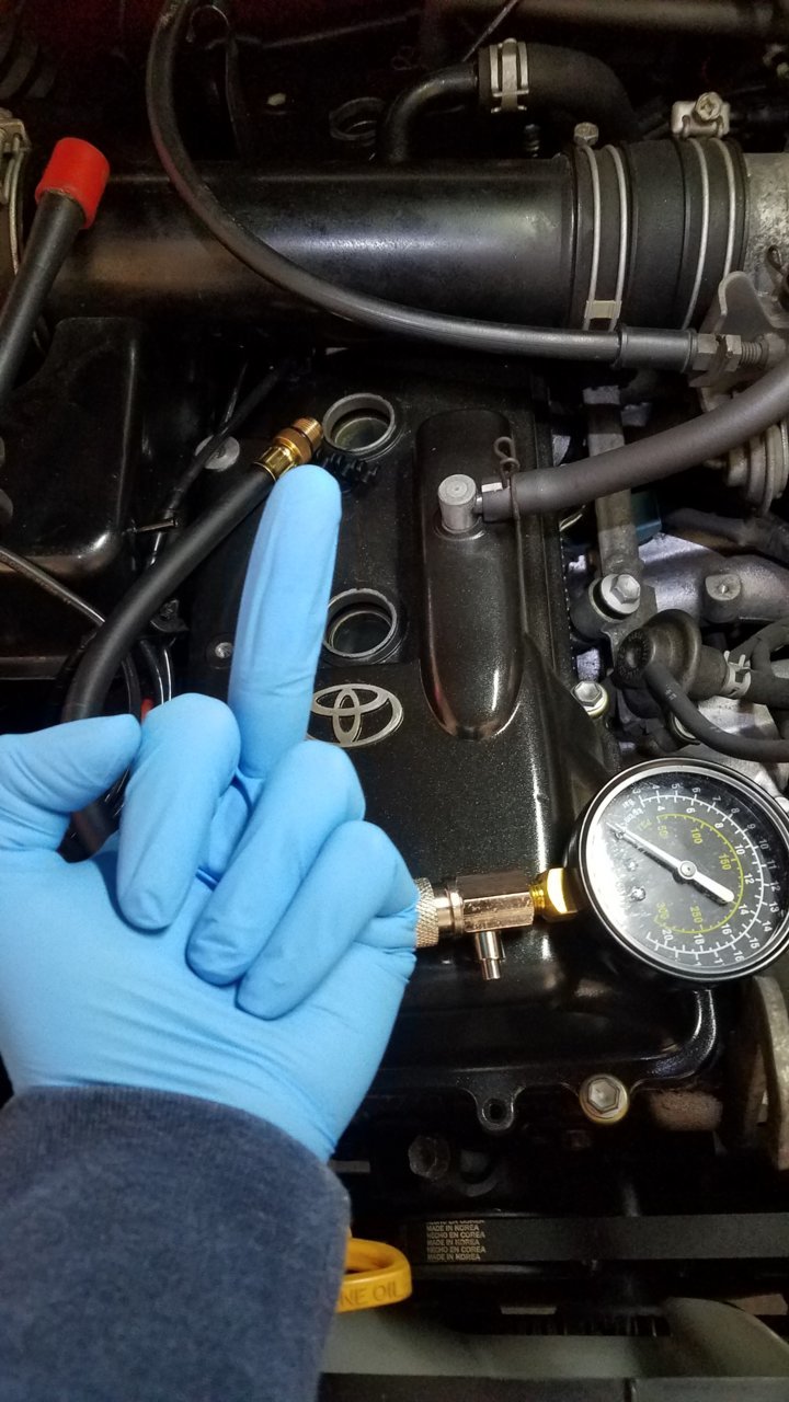

    1 - 180
    2 - 180
    3 - 170
    4 - 180
    Should I be concerned about #3?

    Are there any symptoms that you're trying to address with this compression test? If everything is and has been 'normal', I wouldn't be concerned with it if I was in your shoes.
    With the age and miles we're getting up to on our 2.7s, when the weather warms a bit, I'll be checking the valves and valve lash. Haven't been under the valve cover in the 3 years I've owned it.
