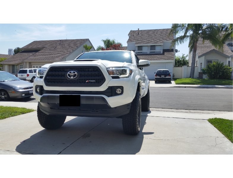

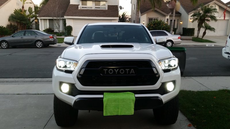

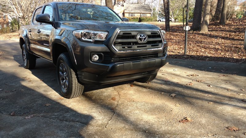

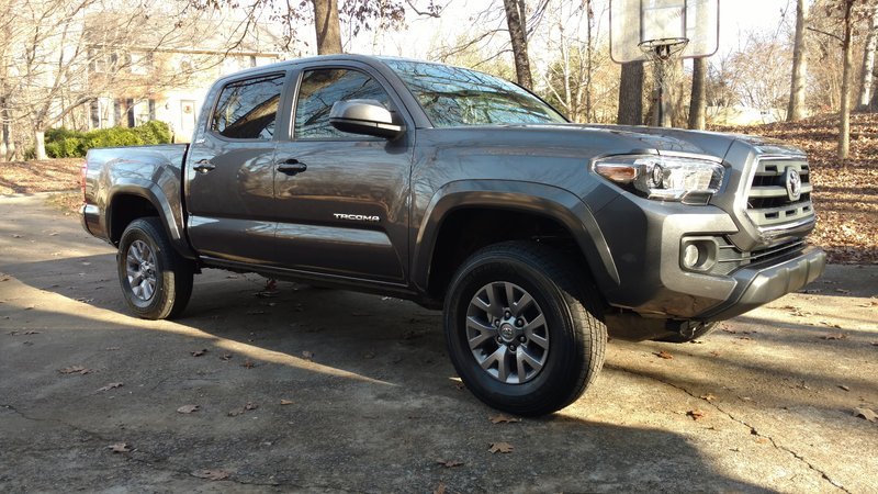

    Before and after photos. Took mine off first week I had the truck.

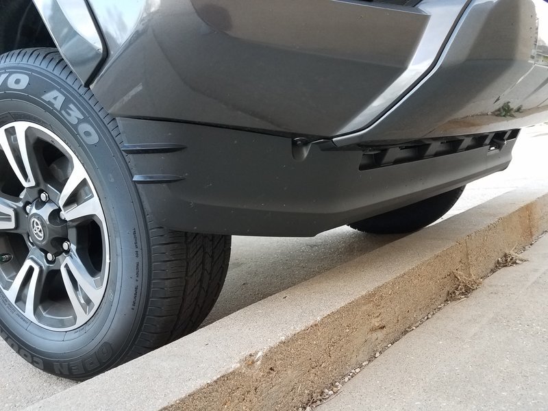

    You'd be quite wrong on that. Tires are actually quite crappy aerodynamically, and even tiny little deflectors like this:
    can make a difference, not to mention manicuring the incoming air UNDER a car or truck makes a colossal difference in drag coefficient.
    Optimally none of your tire would be in the air stream, but for obvious reasons it has to be a balance because that kills clearance.
    Notice this is why the GM twins puts in better mileage than the Tacoma: look at the front of it and see how low it gets to the ground and how much of the tire is covered. It's also why the GM twins are crappy offroaders compared to the Tacoma.
    Anyways TL;DR it is better, but the difference is ~1 MPG or so in practical use. I currently have mine off, but when I make a 2400 mile road trip in April it is going straight back on there.
