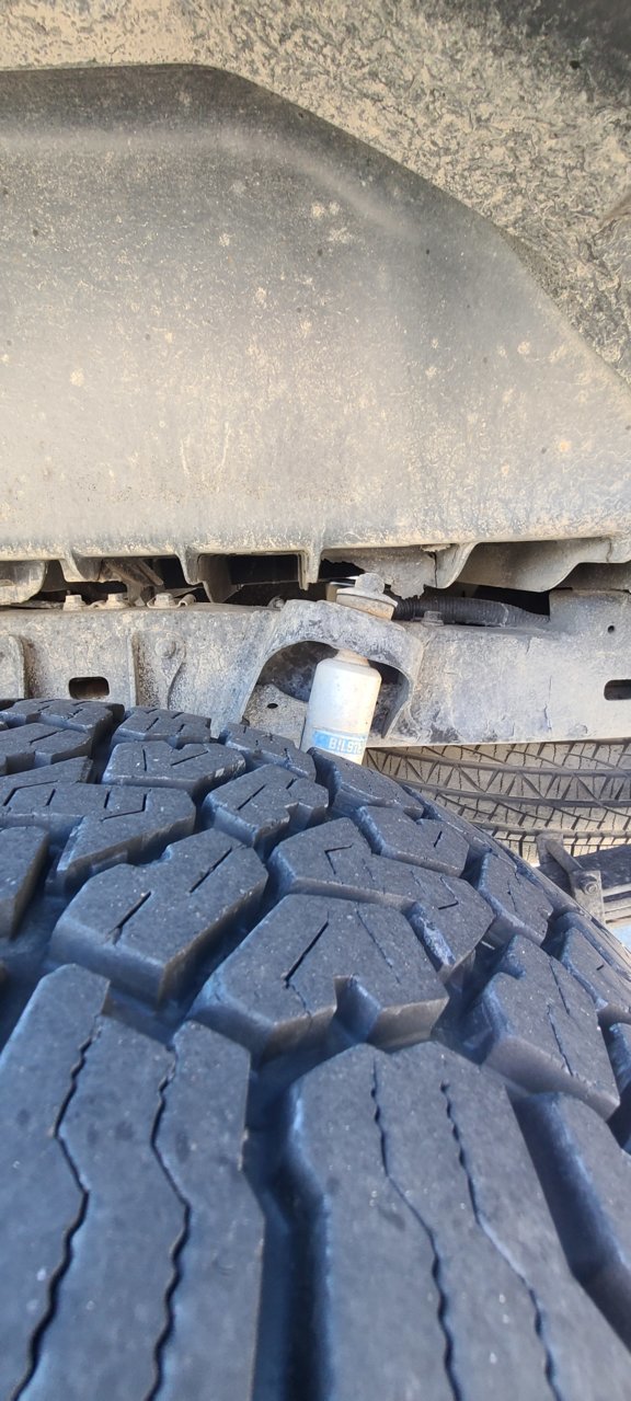

    What about mine? The dealership didn't really fill me in when I asked for details and I was too happy to actually pick up the truck that I didn't press them.
    Now I wanna get some rake back and get a better alignment.
    Is that a 1 inch puck? They say this was a 3 inch lift. The struts look stock but maybe they're not and they're adjustable?

    @Taco X, Appears you have a ~4" spacer lift on the front from comparing the tape ruler size to the bracket size.
    I do not recognize this spacer brand/manufacturer.. maybe someone else will chime in. I full expect that you have a block over the rear axle near the ubolts.

    Looks like 1 1/2 spacer which equals 3 inches of lift.
    If it is 2 and you have 4 inches of lift, your CV boots aren't going to last too long.

    hard to tell, but if they say you have a 3" lift, and that puck is 1.5", I'd say they're about right.

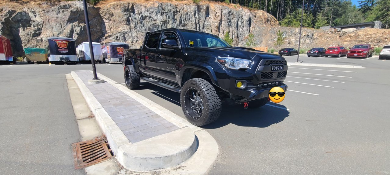

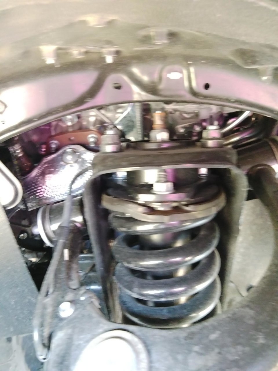

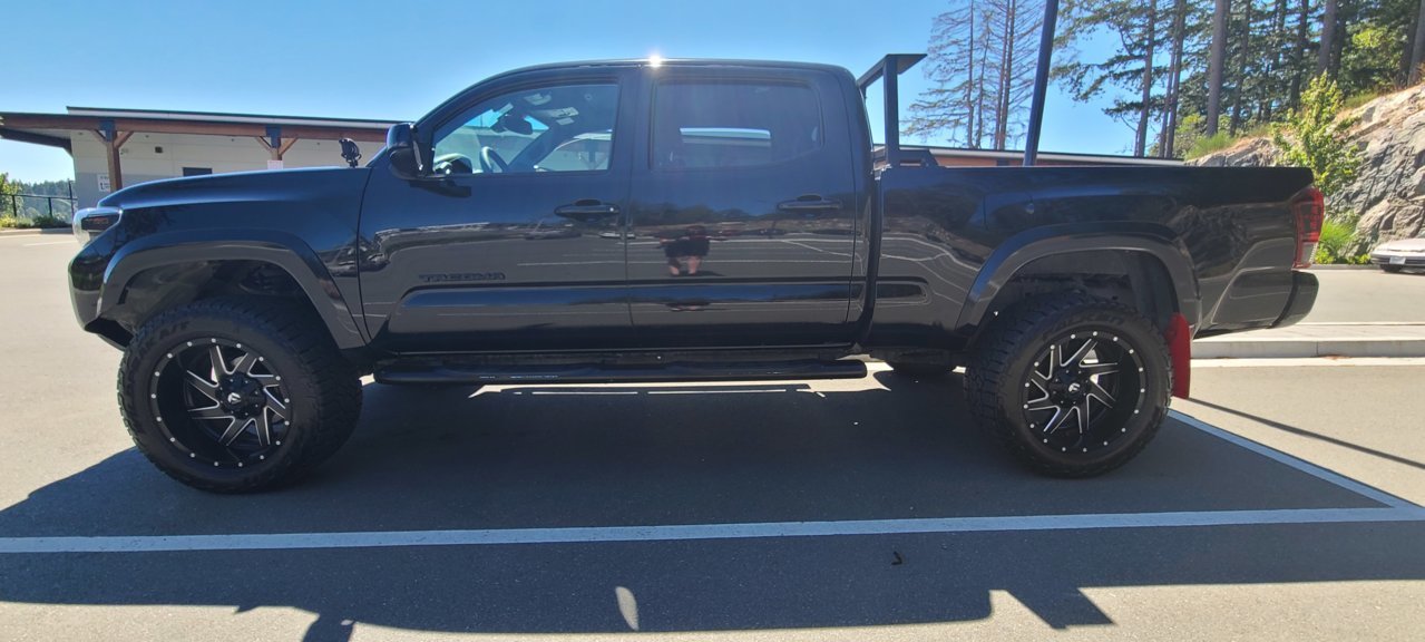

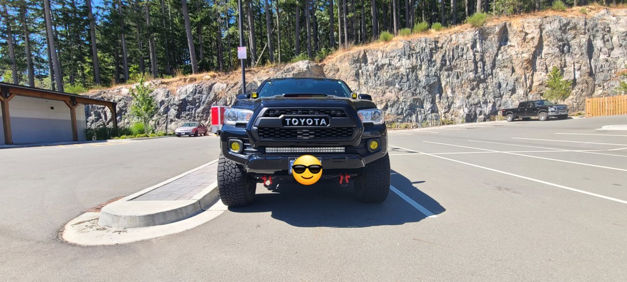

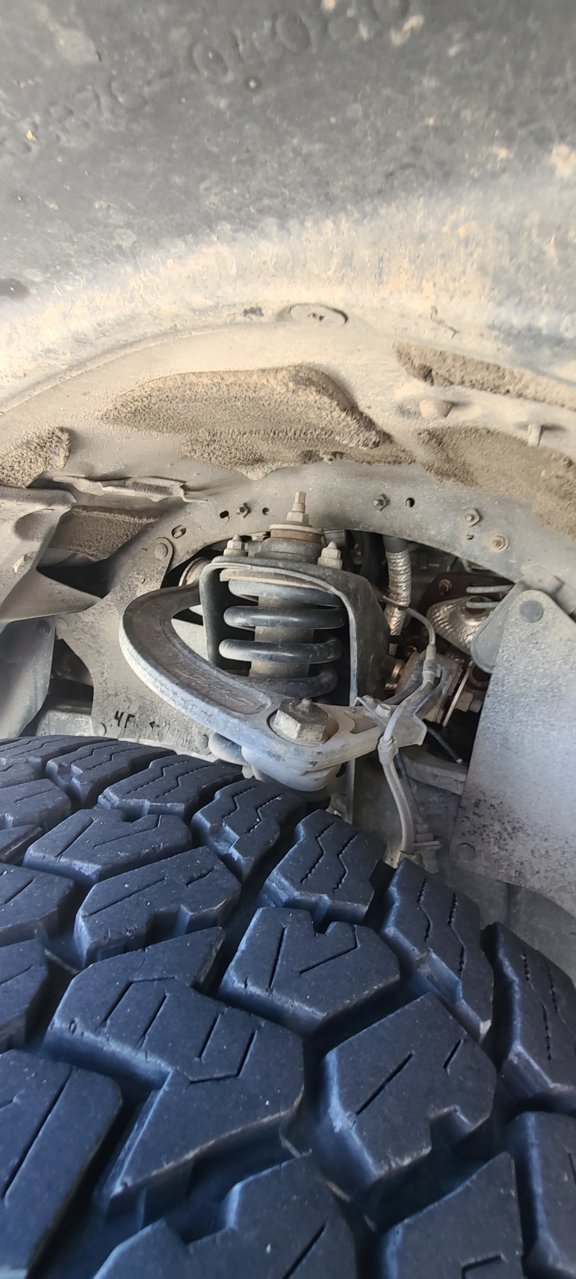

    If you didn't know, I clearly have no clue what I'm talking about, you do now lol. Sorry about the lack of photos. Here are some photos.

    That's a suspension lift, not a spacer or bracket lift. You will have to measure from hub center to fender and compare to stock for your model/trim

    you don't have a spacer up front, which means any lift you have from the coilover. Looks like a 5100 shock, I'd be willing to bet the spring set up on the highest setting, which is, if I remember correctly, 2.5" of lift.
    Can't tell for the rear, since we need a pic of where the leaf spring is bolted to the axle. but since it looks from the side pic that it has some rake, I'm sure there's a block there. In the front, a pic of the whole coilover would help.
