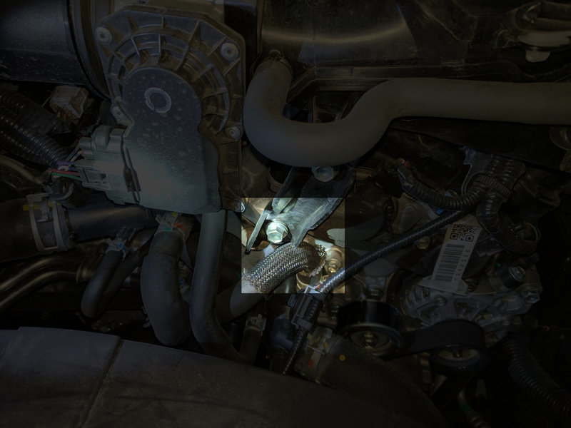

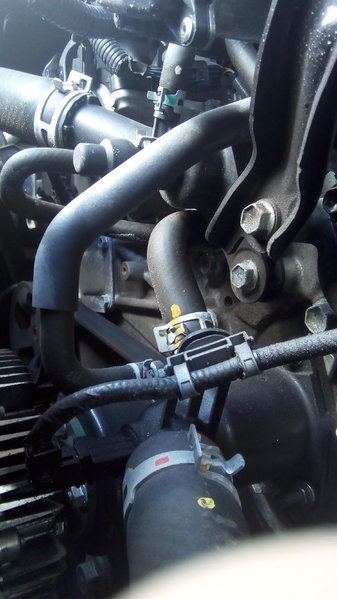

  15. Mar 18, 2017 at 3:37 PM
    boynoyce
    boynoyce .
    Feb 23, 2016
    #179183
    6,228
    16SR5AC4X4V6QS
    maybe this:
    under my hood-
    under the hood from this thread:
    https://www.tacomaworld.com/threads/imminent-cooling-failure.476201/
    this thread also points out that there may be an issue with a cooling hose rubbing a steel support- something anyone might want to check also. I believe that since my truck does not have the towing package, no problem for me- never definatively answered, but it seems like the cooling hose in question is part of the towing package- hope this helps
