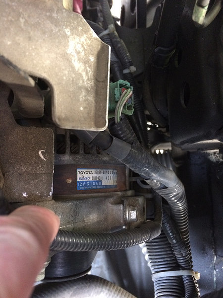

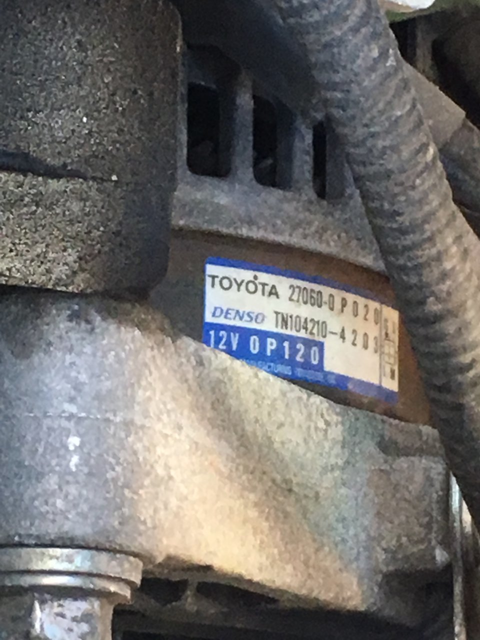

    It would be almost impossible to know without looking at the alternator to find the part number on it. The cases look the same.
    On the V6 trucks the 130A one is part number 27060-0P020 and the regular ones are 100A (27060-0P030) or 90A (27060-0P010). That was true of 2nd gen and I'm fairly certain those are still the current part numbers.
    The other stuff, oil cooler, AT cooler, etc are easier to verify by sight.

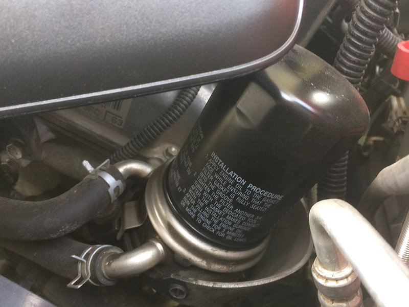

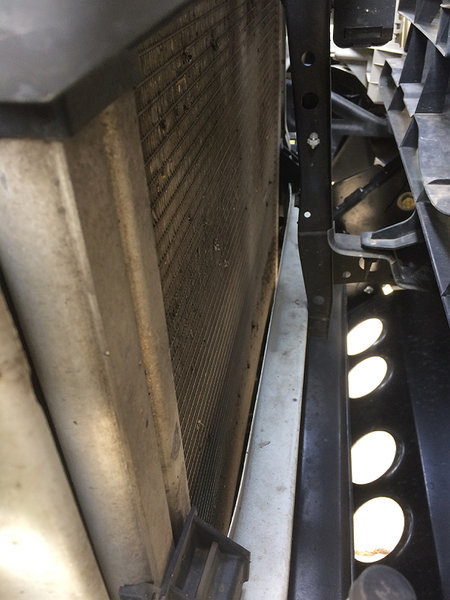

    I took a picture this morning of the "cooler" in my truck which has the tow package from the factory. I don't know if the cooler pictured is the oil cooler or the transmission fluid cooler (or both). I would guess it's transmission fluid. This black colored cooler is mounted on the driver side in front of the radiator.
    boynoyce likes this.
  9. Mar 21, 2017 at 10:05 AM
    #69
    bladsville
    bladsville Well-Known Member
    Mar 15, 2017
    #213372
    417
    DFW
    2017 TRD Off-Road 4X4 MT
    That is an engine oil cooler. I have the same thing in my truck, and since I have a MT, it is definitely not a trans cooler.

    Do you have an automatic transmission? I think that's the transmission cooler.
    I have the factory tow package (TRD Offroad) with a stick shift. I don't have that extra radiator in front of my A/C condenser.

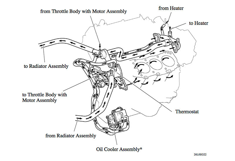

    I have the oil cooler. This on a 1GR-FE 4.0L V6, it's the part under the oil filter with the two hoses. That routes coolant under the oil filter to regulate the oil temperature.
    On the 2GR-FKS 3.5L the oil filter is down low and the cooler sits on the back of it. It routes coolant from the top of the radiator and returns it into the thermostat housing.
    I also have the 27010-0P020 (130A) alternator.

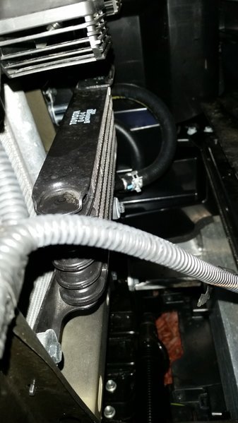

    Exactly. Wouldn't hurt to check for the tranny cooler behind radiator as well, looks like a small radiator.

    I looked up the part number for my alternator and the small cooler in front of the radiator. Answer is that if you have the transmission cooler, 130Amp Alternator, receiver hitch, and a 7 pin Connector then you have the full tow package. I thought I didn’t have the tow package on my work truck because the older models actually had a tow mode button but it turns out I do.

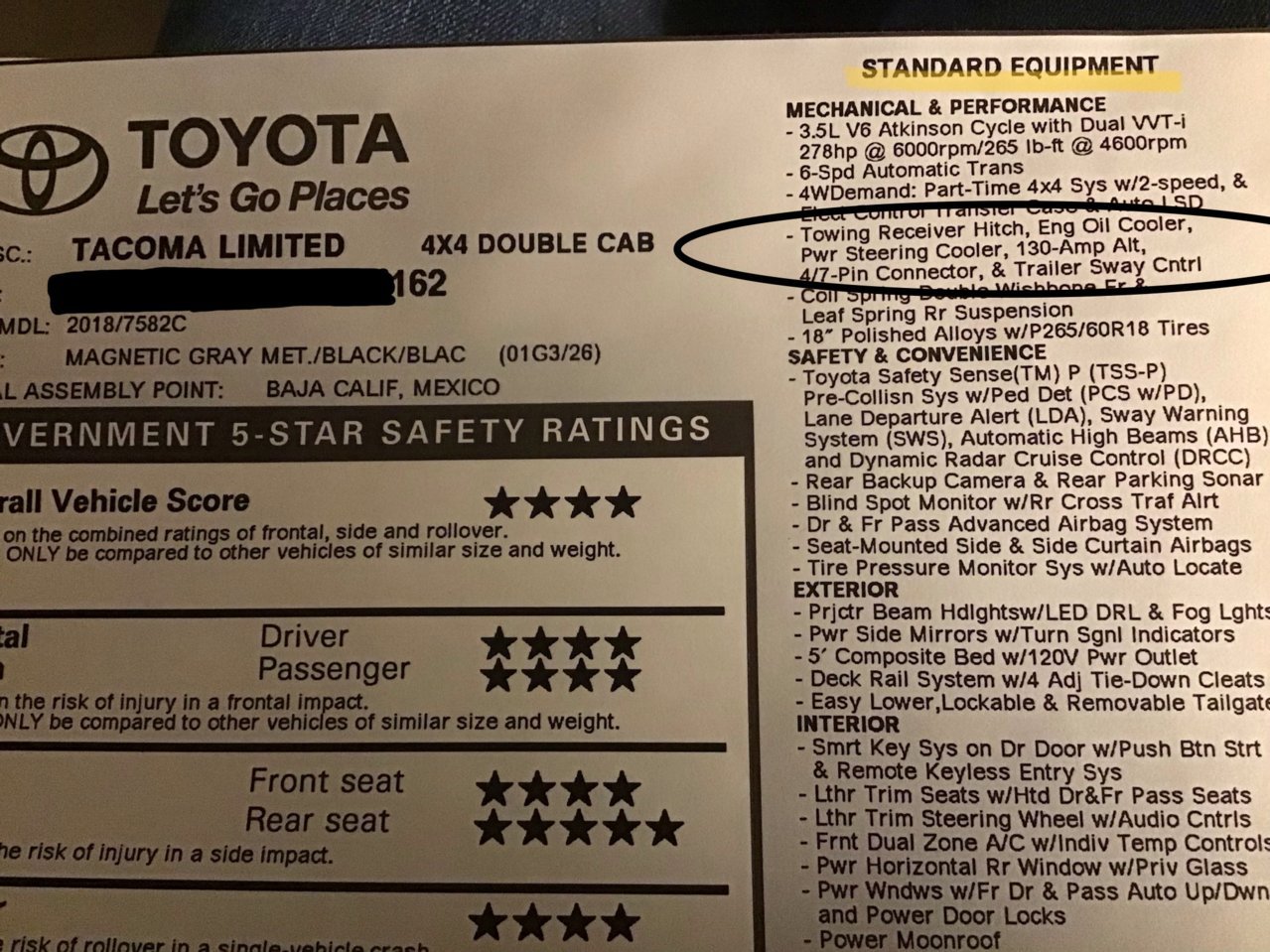

    If you go to toyota.com and sign up for an owners account you can look up your vin and find out what was original

    Uh... wrong, 2018 Limited Standard Equipment includes tow package
