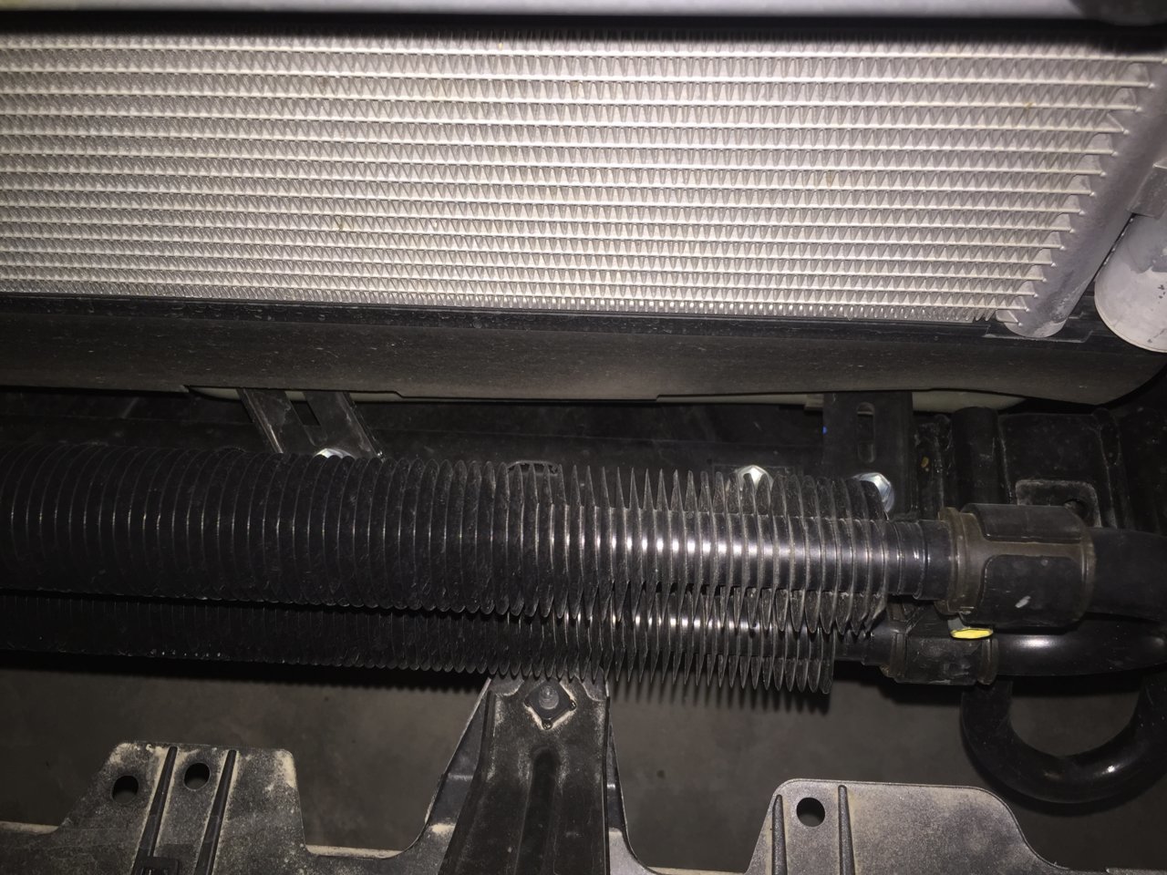

    If this is a tow package, it was standard equipment on my 18 SR5.
    I have this thing...
    And this 2 row cooler thing near the bottom of my radiator.

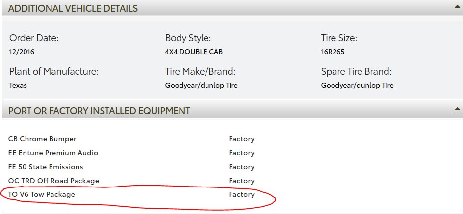

  11. Jan 14, 2019 at 9:39 AM
    #91
    seang
    seang Eternal Noob
    Oct 20, 2015
    #167199
    909
    TX
    17 White Off Road
    this is definitely the easiest, and most accurate way.

    Could this two tow cooler at the bottom of the rad be a power steering cooler? Part of the tow package?

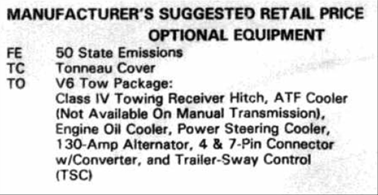

    So, interestingly enough, looking at the sticker from my truck, my truck has the "tow package," to include the 130amp alternator, 4/7-pin connector, receiver hitch, engine oil cooler, and power steering cooler, but it says nothing about a transmission oil cooler...

    Do you have a Manual? They don't get a Transmission cooler. Only the Automatics.

    If it's an AT with the tow package it will have an external trans cooler and a trans thermostat.

    If the factory tow package is listed on the sticker, then it has the transmission oil cooler and higher capacity alternator.
    If the dealer simply installed a hitch, then it probably just has... a hitch.

    I believe in 2018 all V6 Tacoma's came with it as standard equipment, so it may not be listed on the sticker as it was prior to then.
