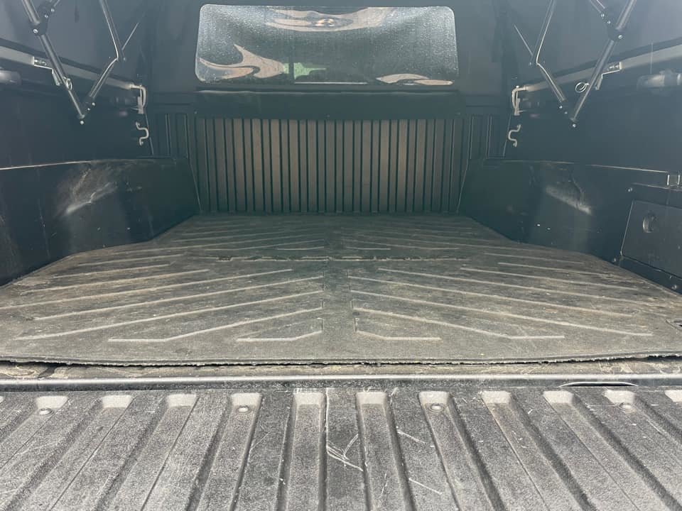

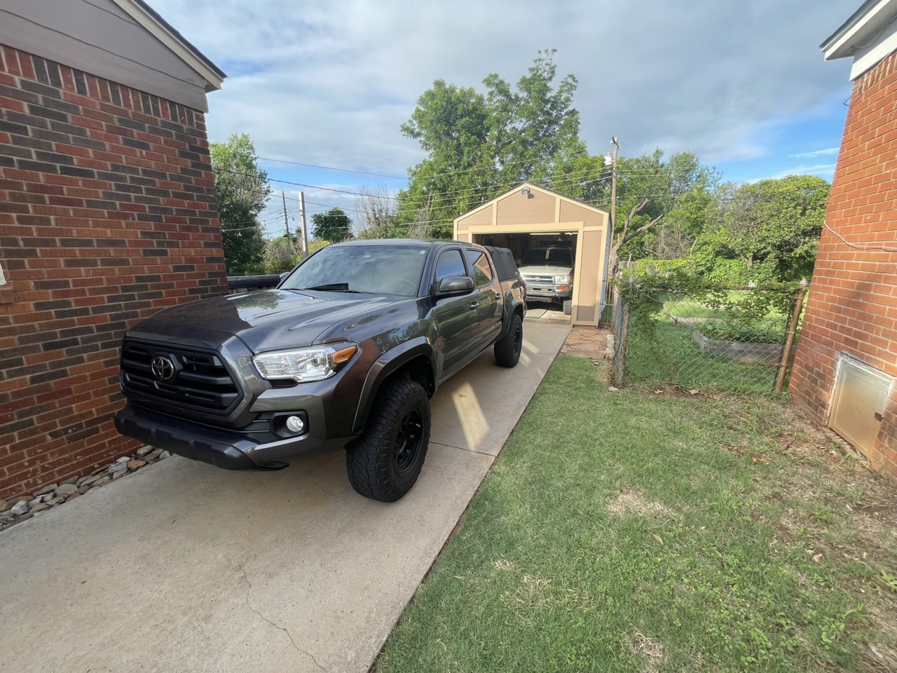

    its awesome. got it for my pup, but also like the look of it. keeps everything i'll ever have back there dry enough. it really only gets water in it when it sits in heavy down pour. If i used more sealer and a little work i could probably make it more water tight. i think i could keep 100% of water out. the best part about it is like $850 shipped, it comes off in less than 3 minutes. probably about 5 to throw up if you keep the rails attached on the truck. old pic but you can see some water dripping under my mat, it drips through the sewed in straps, also while driving comes up through holes in the bed. they say cold will crack your windows, but i've avoided that so far.
