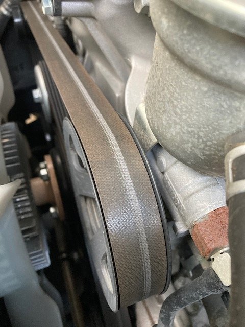

    I just got home from a 3 hour drive. While I was unloading from the back seat on the driver's side I noticed a very faint smell of burnt rubber. I only noticed it a couple of times, but it made me want to investigate. I couldn't find anything conclusive, but while looking at the engine, I noticed that the back of my serpentine belt has a grey stripe on it, about 1/8" wide, right in the middle. It's not like a deep groove, though the texture is just slightly different there. It almost seems like it could be an intentional marking on it. I've got about 58K miles and this is the original belt. Do any of yours have this?

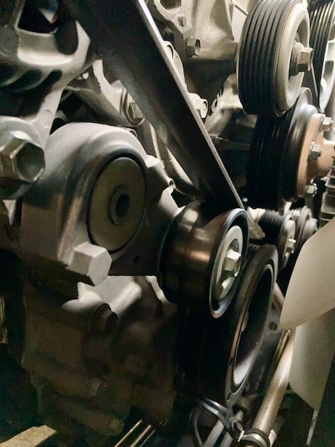

    Here you go....
    There's a stripe on this tensioner pulley. No idea which came first though.

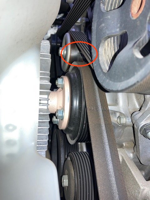

    You can see a stripe on this tensioner pulley as well.

    Problem. Shouldn’t show stripe. Why not try new belt.

    And tensioner pulley.

    UPDATE: We have a local shop that used to only work on Hondas. We had a 97 Civic for a long time and they always did great work for a good price. They recently started also working on Toyotas so I took the truck there. They said that they found a bug or some kind of small lump of something on one of the tensioners. They scraped it off and said I'm good to go (for free). No need to replace the belt or pulleys. Glad I got a second opinion.
