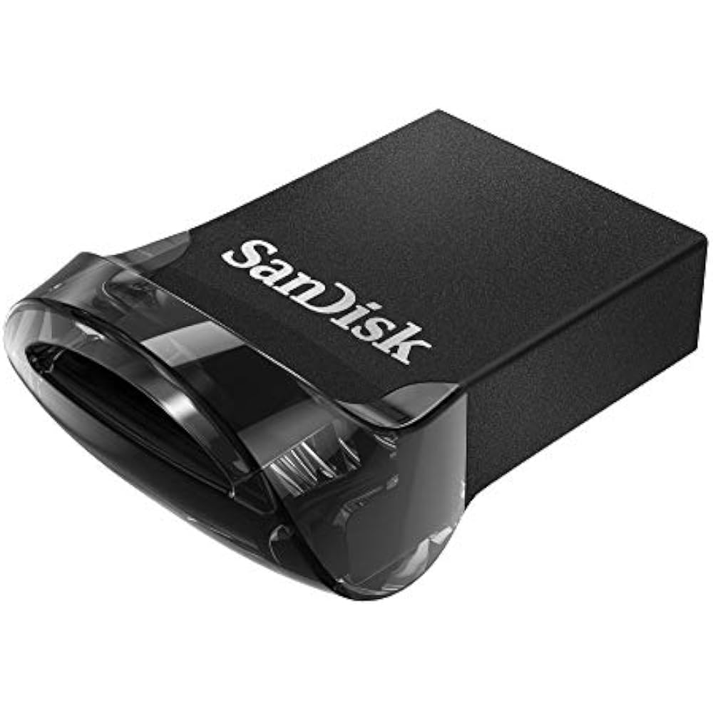

    Have you considered just using a 256GB USB Cruizer Ultra Fit flash drive in the USB port, and let the headunit control it, including shuffle?
    https://www.amazon.com/SanDisk-256GB-Ultra-Flash-Drive/dp/B07857Y17V
    [​IMG] [​IMG]
    Grossomotto, tcjacado and daveeasa like this.

    I read that there is a 2000 song limitation for flash drives plugged into the USB port. That won't help me. plus I like the fact that when i get something off itunes via my ipad or what ever, Icloud will download it to my Iphone 8 "ipod" in my truck as long as its in range of my wifi at the house. Come out in the morning, get into the truck and my newly purchased album from last night is all loaded up on the iphone 8
