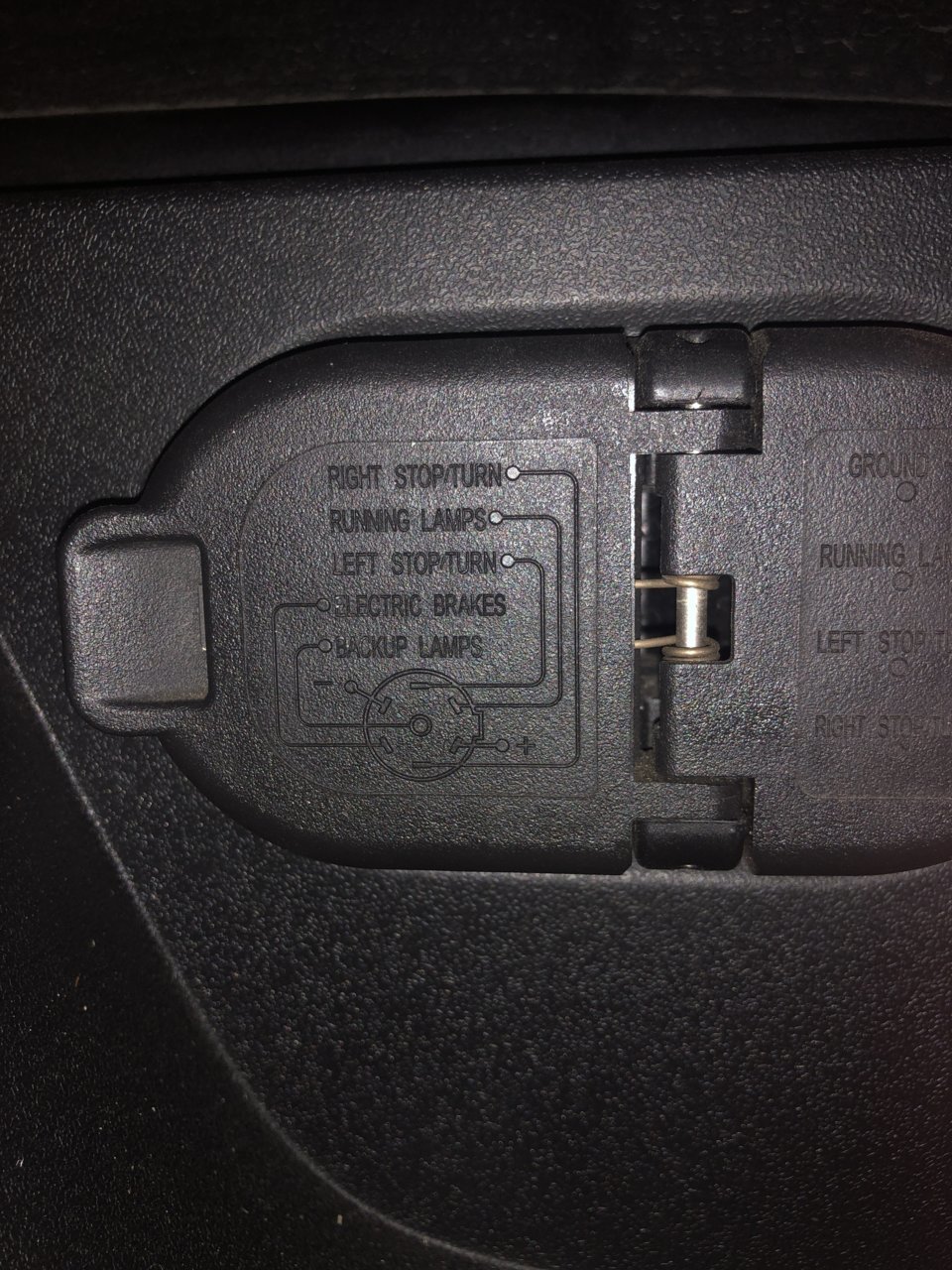

    Have a 2018 OR w/tow package. Also have an rpod 190 and am wondering if I have the trailer plugged in and towing is the truck charging the campers on board battery? If not, what would I need to do that? Thanks.

    IF YOU ARE USING A 7PIN CONNECTOR THEN YES YOU ARE CHARGING THE RPODs BATTERY. Sorry, not yelling it out.

    Look at the pin diagram on the connector attached to the truck you will see which is battery power.

    So I’m seeing everything in that diagram on my plug in cover diagram but the 12V portion. So maybe it doesn’t charge the battery?

    Two of the pins show + and -... I assume that's them.

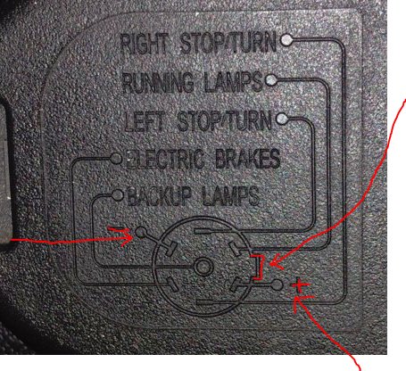

    Pretty sure the + sign is the 12v in the above diagram. And the - sign would be the ground.

    Also, realize the orientation of the plug in the diagram vs how the truck plug is. The protruding part of the plug is on the top in the diagram but on the right for our trucks.
    They are showing the same thing.

    The + and the - are the 12v hot and ground.
