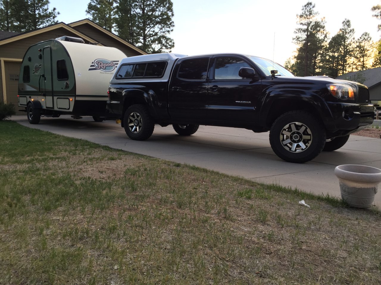

    I also have an R-Pod and can attest to the fact that my truck does charge the battery while the truck is on.

    Your setup looks great. We looked into the RPODs but we like having our ATVs with us too. Not enough truck to tow it all, so we had to go another route.

    Thanks! The R-Pod was as big as I was willing to go without having to buy a new truck.

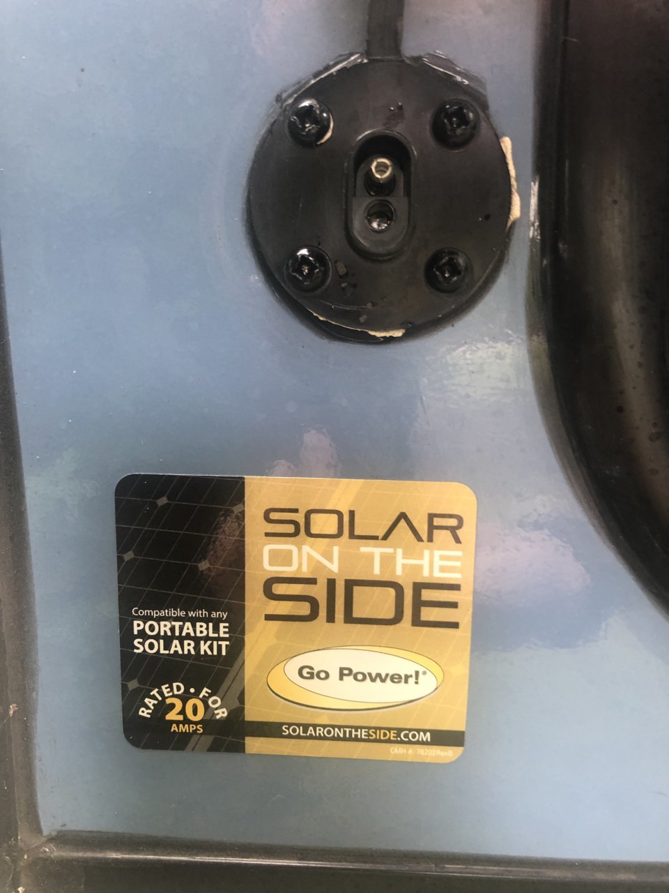

    Yeah I have this on the side of the rpod. There’s nothing in the rpod manual about solar so I’m not sure where to even look for info. My rpod bought brand new didn’t even come with a paper manual, had to download an app.

    Solar on the side looks like it requires a kit with a charge controller. Website is here. So, essentially, the plug on the side is a direct wire to the battery. Here is a kit on Amazon that should do the trick, but you'll need the SAE connector and extension. A qualified individual should help with the installation if you're not familiar with panels or not sure of the polarity.
