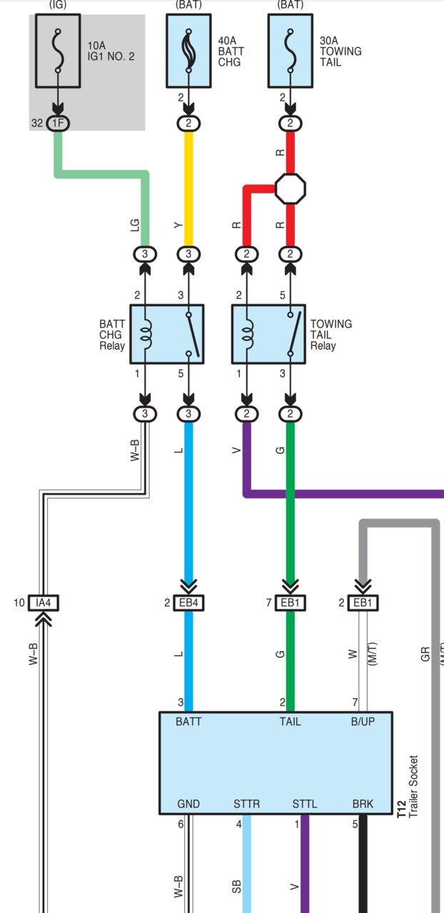

    Is 12VDC always available at the trailer connector or is it switched??? Looking for an electrical diagram now. As it stands I have NO 12VDC present.

    The 12 volt is powered by the Battery Charge Relay. The relay is switched with ignition.

    I got things figured out. I had two broken wires in the wiring harness to the trailer connector outlet. Black and yellow both (cut???).

    As long as nothing is drawing from the trailer battery. No refrigerator, no nothing. Somewhere 2005-6 Toyota reengineered the charging systems. The “smart” or variable voltage alternator will not keep up with any amp draw. My 2003 Tacoma would freeze up my refrigerator in my T@b trailer within miles. My 2919 won’t provide enough amps to keep the trailer battery from discharge on a 8 hour drive.
