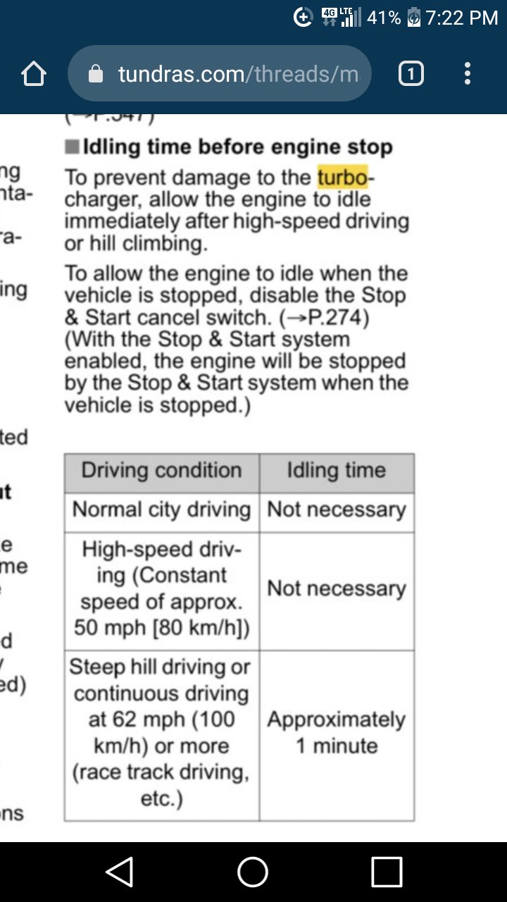

    While I have about .001% of your knowledge, I was thinking about this last week re the 2022 Tundra, which I'd been toying with the idea of getting. Not crazy about start/stop though & this looks like it would be a royal PITA.

    Yea I don't like it either but thanks to the EPA most new vehicles have it, most can be disabled with a button (although they turn themselves back on every key cycle).
    Some can be permanently disabled with minor mods while others can not although I don't know about the Toyota system as I haven't seen one yet.
    I feel like starters and batteries are going to become popular failure items in the next few years if this continues to be a thing.
    Not that I want people to get hurt but I'm hoping there turns out to be enough issues with accident's and people getting stuck in traffic because of them that the start/stop crap goes away.
